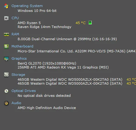

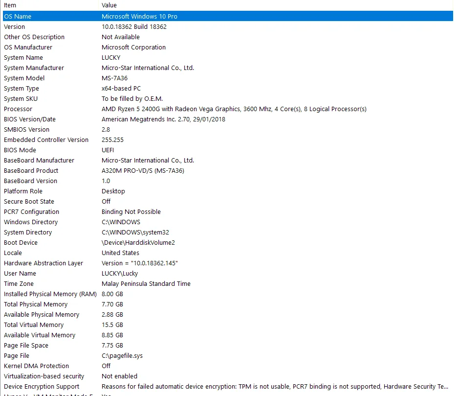

Ayyyyy nakita ko builds mooo so you're trying to upgrade??? if gusto mo mag upgrade better change processor yung walang onboard graphics, pag yan parin cpu mo magbobottle neck mga ilalagay mo na gpu dahil may sariling graphics na siya

Recommendation: RX580 8Gb paired mo ng another 8GB RAM
Advice: Benta mo yung processor and RAM, bili ka ng Ryzen 5 2600 or 2600X paired with 16Gb 2666-3000MHz RAM plus RX580 8Gb graphics card. Support naman yata ng mobo mo magOC, mag a-add ka nga lang ng fans.
