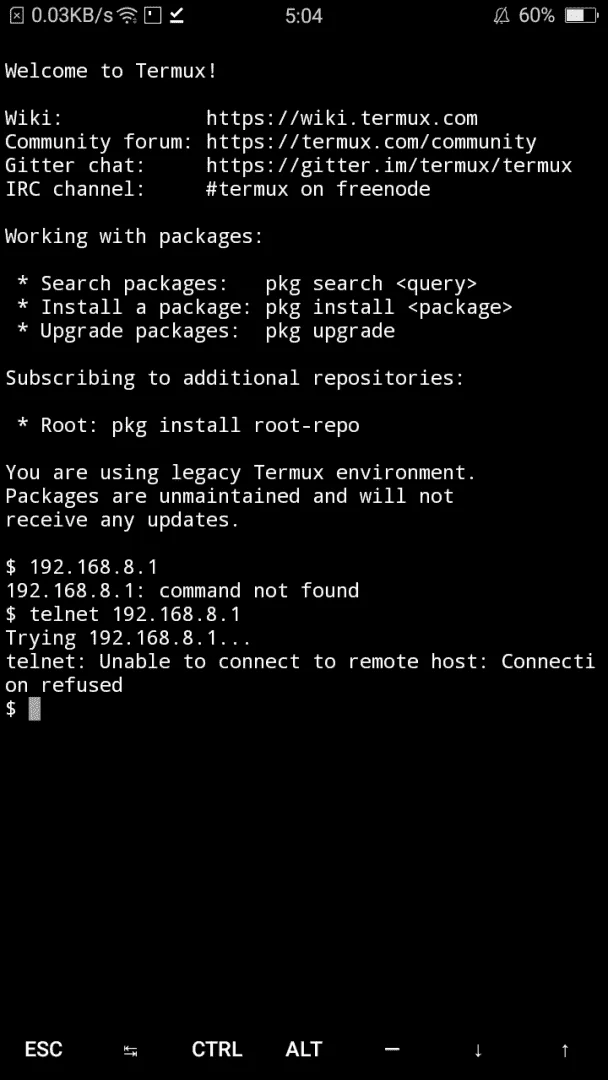

Check mo muna TS if makakapasok sa telnet
Here's how:
Thru android phone para madali,
Install termux,
then connect sa 936 modem,
remember do not use VPN para mapasok,
Then, type on termux app,
telnet 192.168.8.1 (press enter)
pag nakapasok pwede,
Pag refused, need mo change firmware na open adb at telnet,
Pero first thing first is salpak mo muna yung GHWP sim para malaman mo if nababasa ng modem mo yung sim,
Pag wala data, change IMEI solution thru telnet

hi lodi paanu mapasok telnet pag walang android via pc lng. thanks
[XX='wilcon, c: 131818, m: 952055'][/XX]
[XX='jehe, c: 132026, m: 1028409'][/XX] badly need your help. Paanu po pag Putty gamitin? d ko alam panu process please po.
