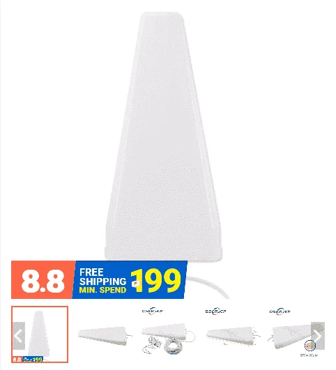

Kung hanap mo is para sa band 28 bili ka nalang log periodic antenna boss mas mura pa keysa sa bentahan ng mimo ngayun. Search mo lang sa shopee goods din yung mga feedbacks

Product Description
(16dBi Log periodic Antenna with N male Connector)
Gain: 16dBi
Impedance: 50ohm
Connector: N SMA male Frequency
Range: 698-960MHz,1710-2700MHz
Type: External
Cable: 15m
Customized: Yes
Installation: Outdoor
Usage: For Signal Booster router 1 X Log Periodic with cable N male Connector
Heto boss, sakop niya b28 thanks sa info ni LifeIsShort

nakita ko din yan kahapon. problema nakalagay sa description ni seller di sya gumagana sa modem kong ZLT S10G.
