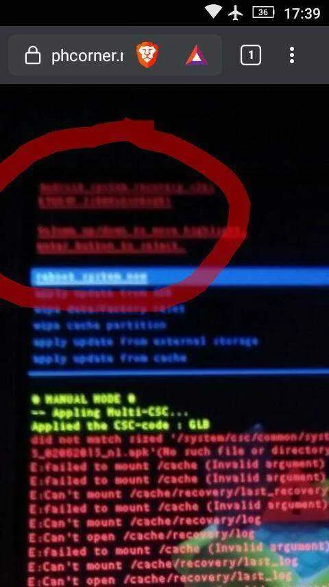

🔒 Closed E: Failed to mount / cache (Invalid Agrument)

Nakapag flash nako. Via odin. . After nung flash success naman sabodin and it say Pass. Pero after nun. Di na ma open.
base on your logs..e failed to mount data..it means your emmc or internal memory damaged/..must replaced it or posible jtag to fix your phone..kung may kakilala ka marunong mag jtag..yun nlang tanging paraan para magawa unit mo lods..kahit stockrom pa ang i program mo dian useless..kahit pa sd card gamitin mo wala effect yan..
Nag try ako sa odin :( on first. Nag success sa odin. After a minute. I think. 1:23min. After nun. Deadboot na :((((

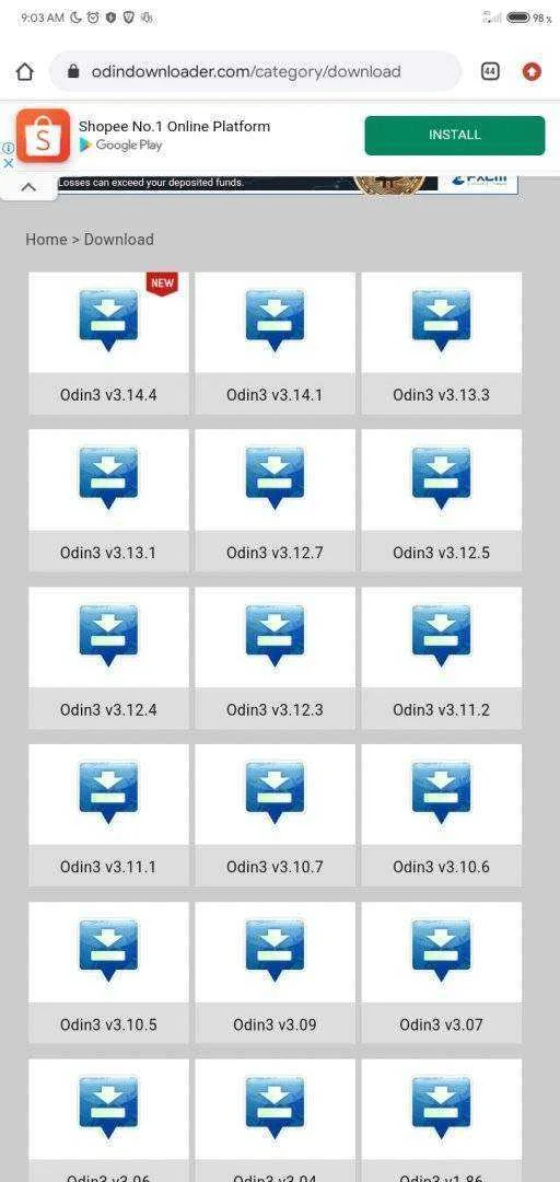

Since samsung yan mas better if odin gagamitin mo
Para fresh flash stock rom
Need mo pc (with samsung drivers installed)
Odin app (download lang thru google)
Data cable
Stock rom (download ka sa sammobile - search mo lang yung model mo sm-xxxx)
