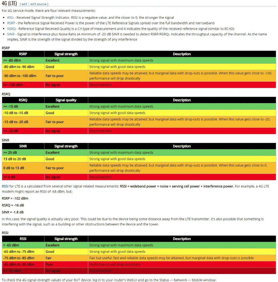

This is simple yet efficient way to read your modems signal. By having a balance of every "Good" or "Excelent" numbers of each measurement, you can have a stable and consistent connection. You can click the link if you still want to read on about this.

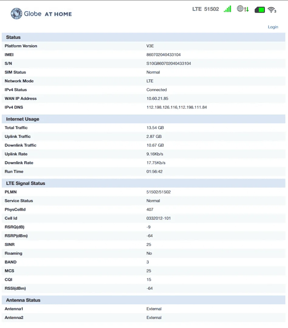

Here's the modem measurement that I have right now, I change between BAND 3 and 41 depending on the time and have a stable locked Cell ID.

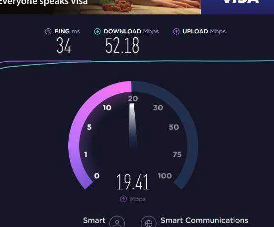

yan yung S10G ko
even walang bar sa signal indicator ay yan yung actual speed

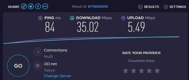

yan naman yung Globe at home sim with vpn (para magamit yung WNP)
