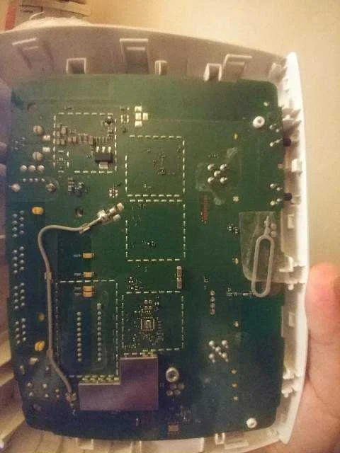

❓ Help Can you help to make openline? It's B310as-938
kni18
Leecher
hello there..
it seems you are flashing incompatible firmware.
Your device is B315as-938
however
* Flashing firmware in device
OPEN THE B310As-938 11.326.01.00.1342.exe
is firmware for another device model B310As-938
Yes, sure. I checked it. and It's not B model. I think so cause there is nothing behind the motherboard
. B model has some mark and design in the back of the motherboard. right?
Sorry. I edited the title. my device is B310as-938. basic Globe modem LOCKED

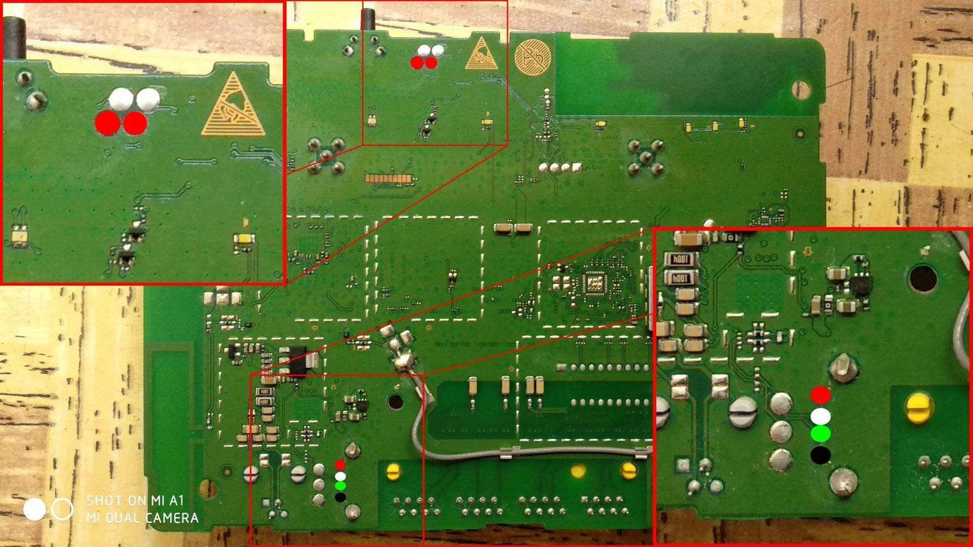

Do you have a red wire connected? If you do, disconnect that and try again. That wire leads to the culprit.
What is the red wire??? I just used the jumper method ---> 2 red spots with metal
can you explain the red, white, green, black color ? when can I use those color???
I have B315s-936 old model ( TATOO model ). But i want to make openline but it's same.......
ERASING FLASH and...stop
