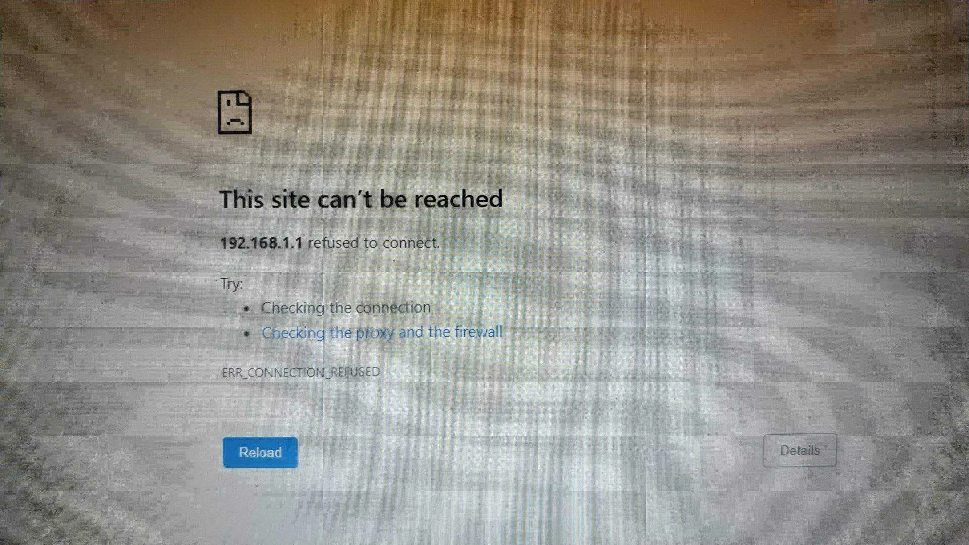

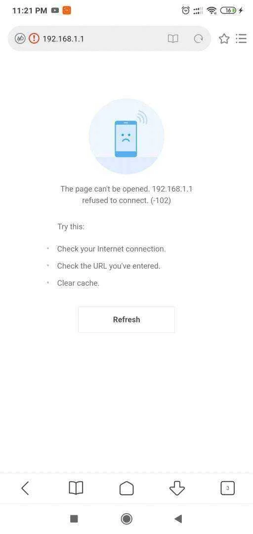

Hi po,

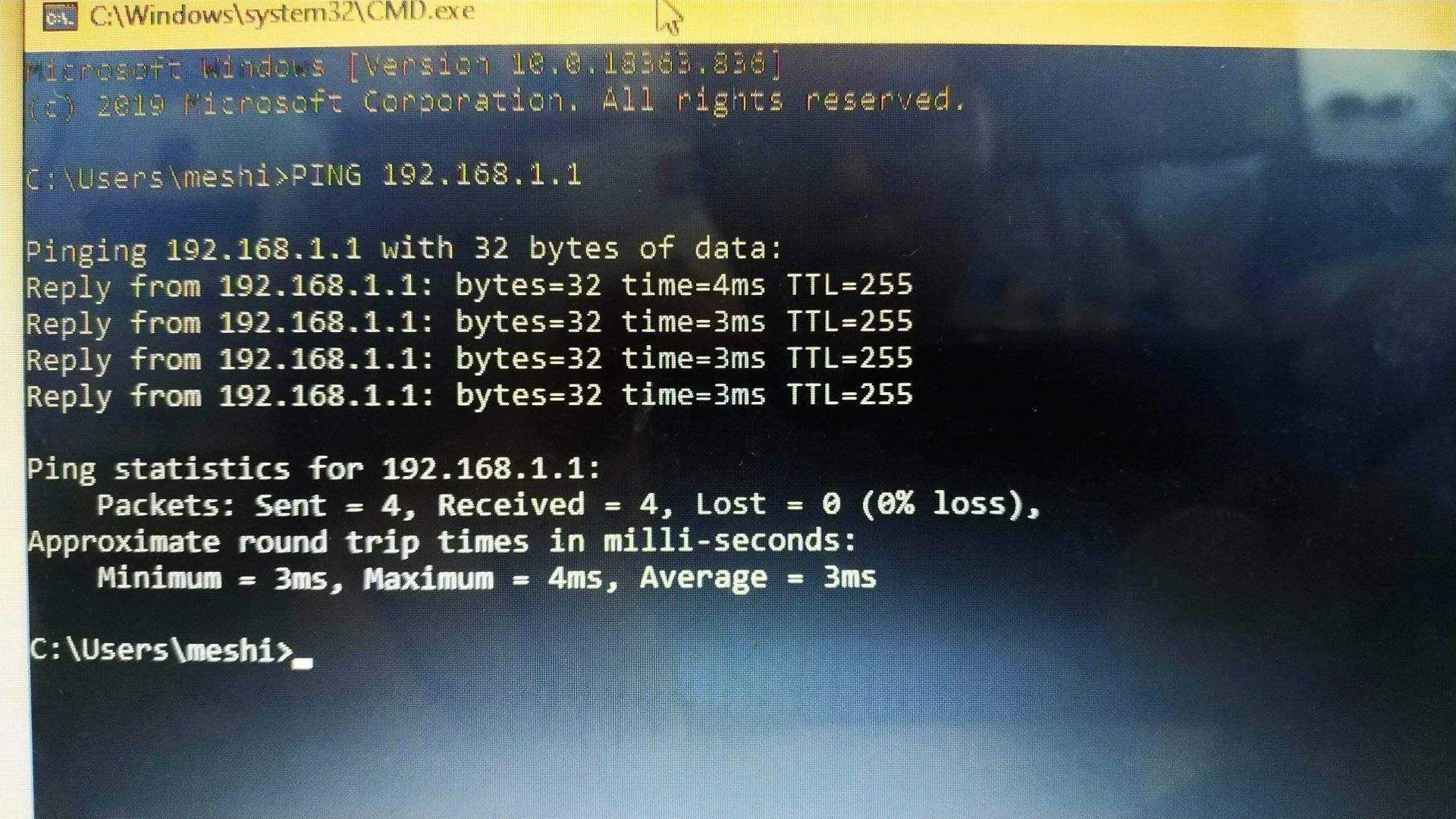

Need help. Meron ako smart pocket wifi lte model M028AT. problem po ay d siya maka open sa 192.168.1.1 or smartbrosettings.net. sabi lng 192.168.1.1 refuse to connet. Na try ko na po lahat ng mga fix suggested na nahanap ko sa net pero ayaw parin mag connect. Baka may naka try na nito or alam panu. Try ko mag ping sa cmd ok naman na ping naman yung 192.168.1.1IMG_20200603_125138.webpIMG_20200603_125218.webp

Connected na po ba kayo dun sa wireless device? if yes paki check yung time ng lappy or pc mo, pwede mo din pong buksan yung dashbord ng pocket wifi by connecting the usb charging cable papunta sa pc/laptop mo
baka hindi yan ang ip address nung pocket wifi mo...
check mo muna...
type mo ulit sa command prompt ipconfig | find "IPv4"
kung ano yung lumabas na ip addess, change mo yung last digit to 1
Yes po connect..na try ko na gamit cable connect sa laptop same problem pa din.
Hola! Same problem here, kakabili lang ng Pocket WiFi worth Php 999.00. Nakaconnect ako sa internet, mabilis siya pero yun nga, hindi makapasok sa settings.
And it worked for me adding ‘s’ to http making the link as ‘https://192.168.1.1’
Thank for it I finally changed my WiFi password 👍🏼
