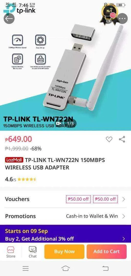

🔒 Closed TP-LINK 722 for Kali Linux
PHC-Alex
Eternal Poster
Working sa Kali Linux Monitor Mode..
sa gustong mag PenTest dyan..
Sundin lang Procedure..
open terminal mga boss..
sudo apt update
sudo apt install bc
sudo rmmodr8188eu.ko
git clone You do not have permission to view the full content of this post. Log in or register now.
cd rtl8188eus
sudo -i
echo "blacklist r8188eu.ko" > "/etc/modprobe.d/realtek.conf"
exit
make
sudo make install
sudo modprobe 8188eu
[Enabling Monitor Mode]
sudo airmon-ng check kill
sudo ip link set wlano down
sudo iw dev wlan0 set type monitor
[Testing Packet Injection]
sudo aireplay-9 wlan0
Sa mga naka Experience ng "no such device (-19)"
-> Reload the right driver manually:
1. (Stick Adapter in)
2. sudo rmmod r8188eu.ko
3. sudo modprobe 8188eu
4. Stick Adapter out and in again
5. sudo airmon-ng check kill
6. sudo ip link set wlan0 down
7. sudo iw dev wlan0 set type monitor
SUCCESS!!
Meron ako nito v2. Napagana ko na yong monitor. But may problema sa Airgeddon. Need ng isa pang wireless o supported chipset para gumana. Sa Fluxion namn, ayaw nya gumana alone. Di sya makapag Captive portal.
version 3 yan ts ah, working na pala ngayon v3. pagkakaalam ko before v1 lng tlaga ih 🙂
