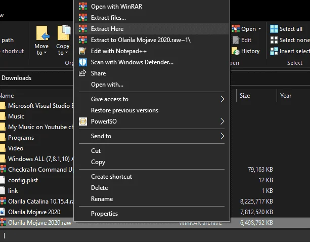

2 : After Download, extract image

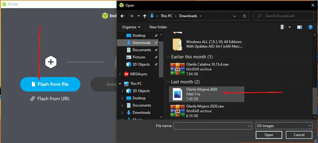

Download Etcher
: eVcV3Jt.webp
  1. Open app and select extracted Image
  2. Select USB Stick(use 16gb USB stick)
  3. Burn Image

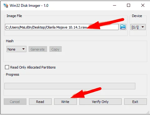

2 Method Burn Olarila image on Windows with Win32DiskImager

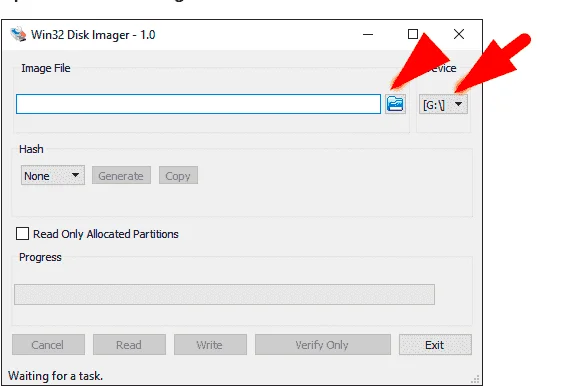

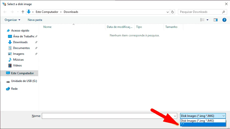

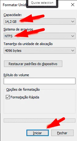

  1. Download Win32DiskImager You do not have permission to view the full content of this post. Log in or register now. Format USB Stick
  2. Open Win 32 Disk Imager
  3. Load Olarila Image
  4. Burn

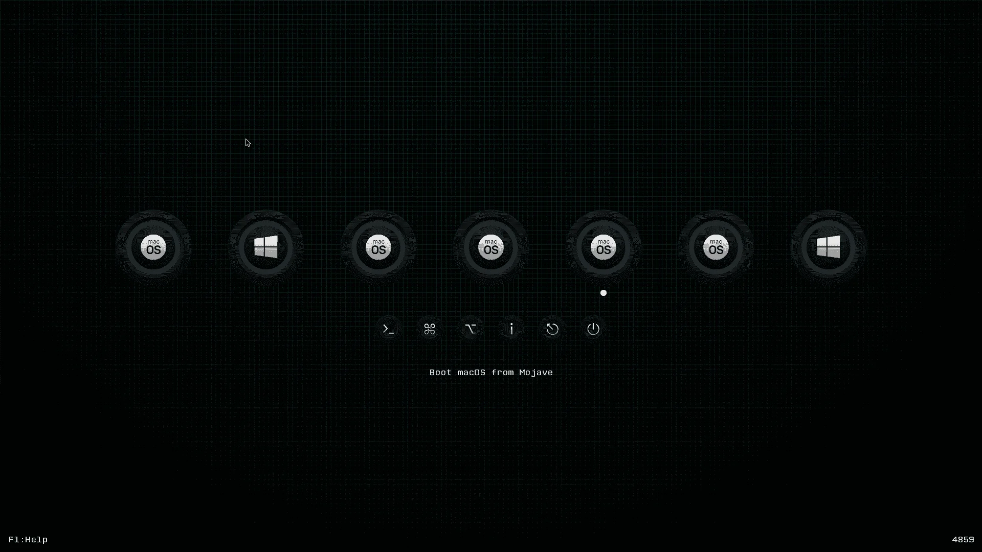

4 : Boot from USB

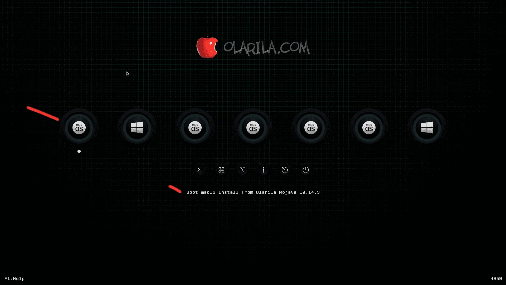

  • Use a boot key(Gigabyte is F12, Asus is F8, etc)
  • Select Boot MacOS Install from Olarila Image

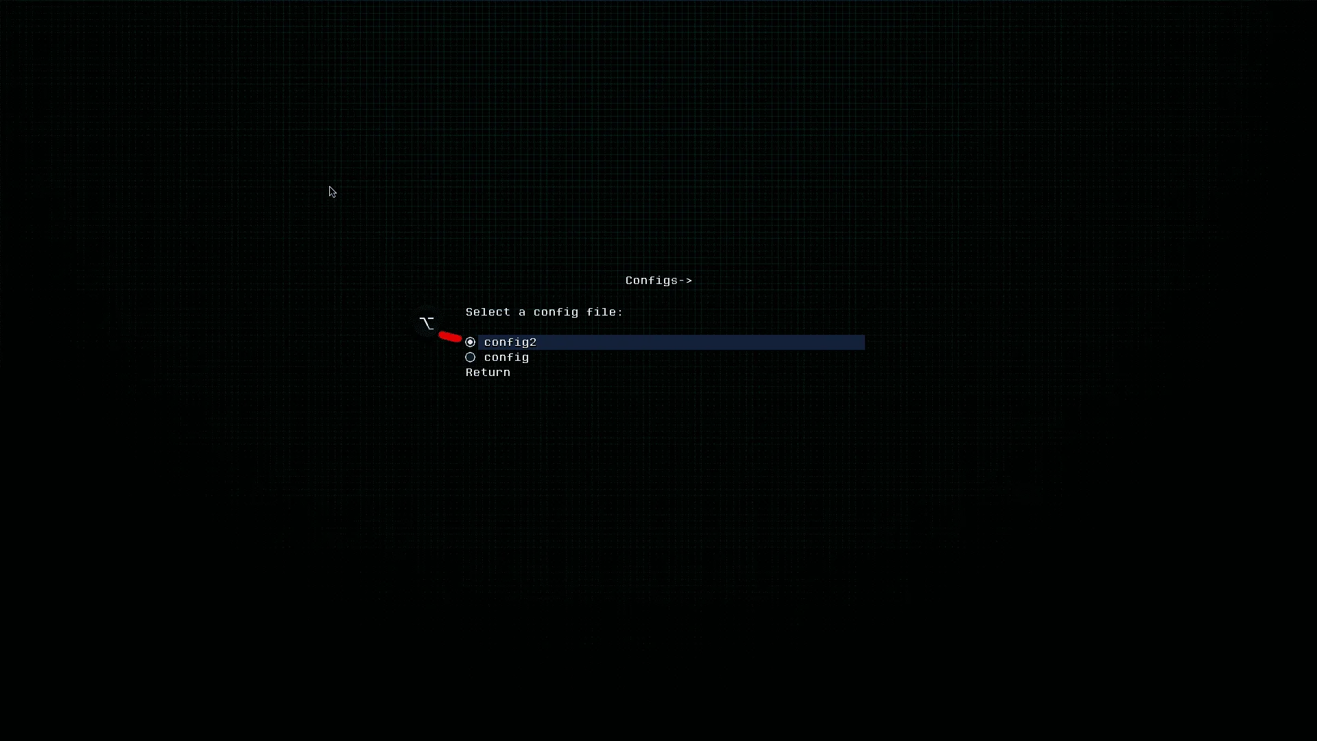

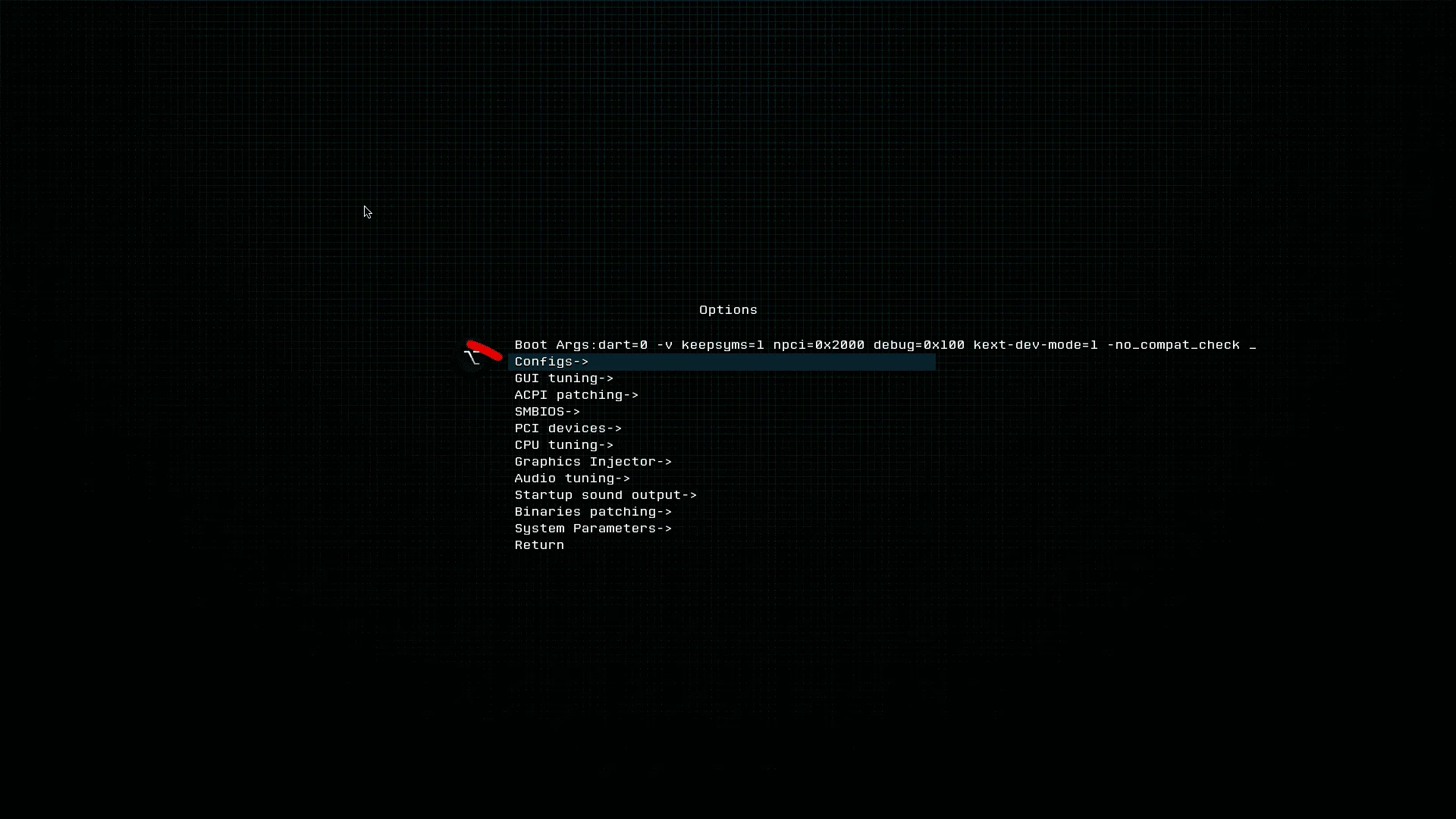

Notebooks users, if default config.plist fail use config2.plist, press O key in Clover boot screen, go to Configs
Select config2.plist

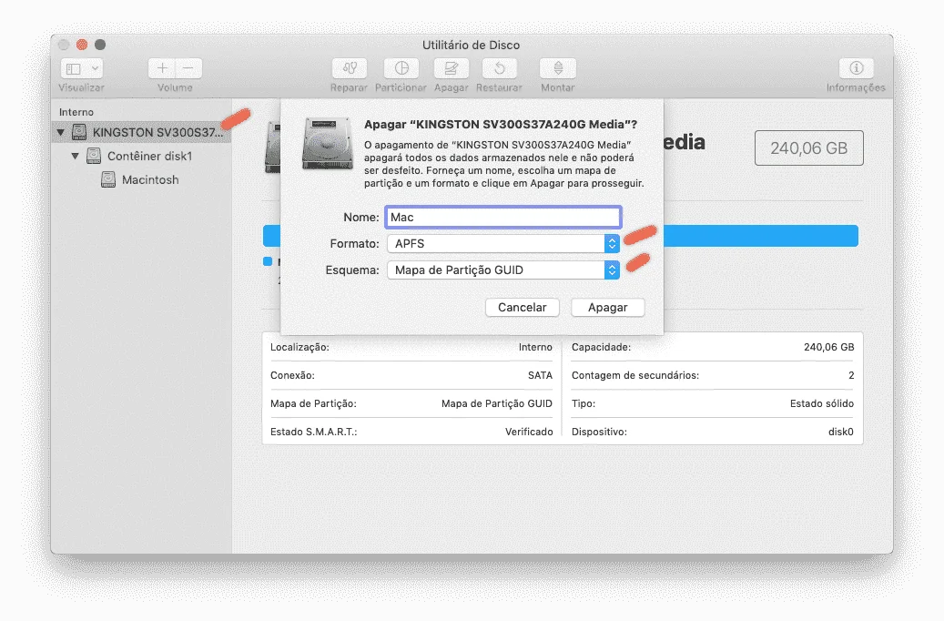

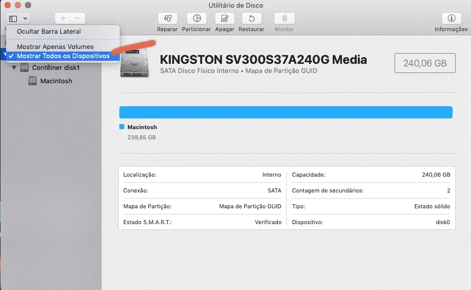

5 : Format SSD
Select "Show All Devices
Format SSD, use APFS and go to installation
After installation, boot from USB stick again, use boot key and select your SSD with system installed

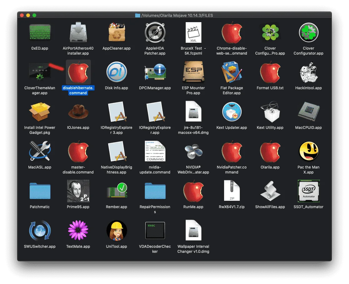

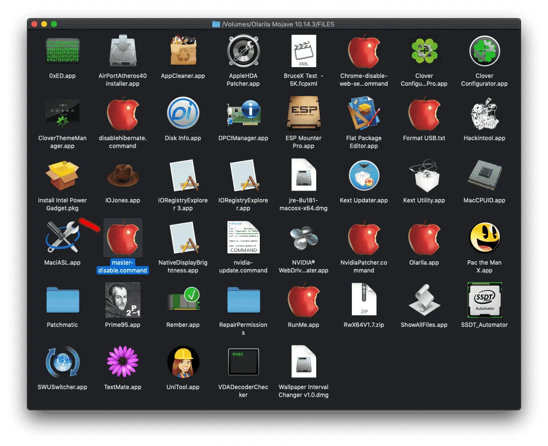

6 : Start a post Installation
Go to Olarila Image/Files folder and run "disablehibernate.command"
and "master-disable.command"
DONE.!!

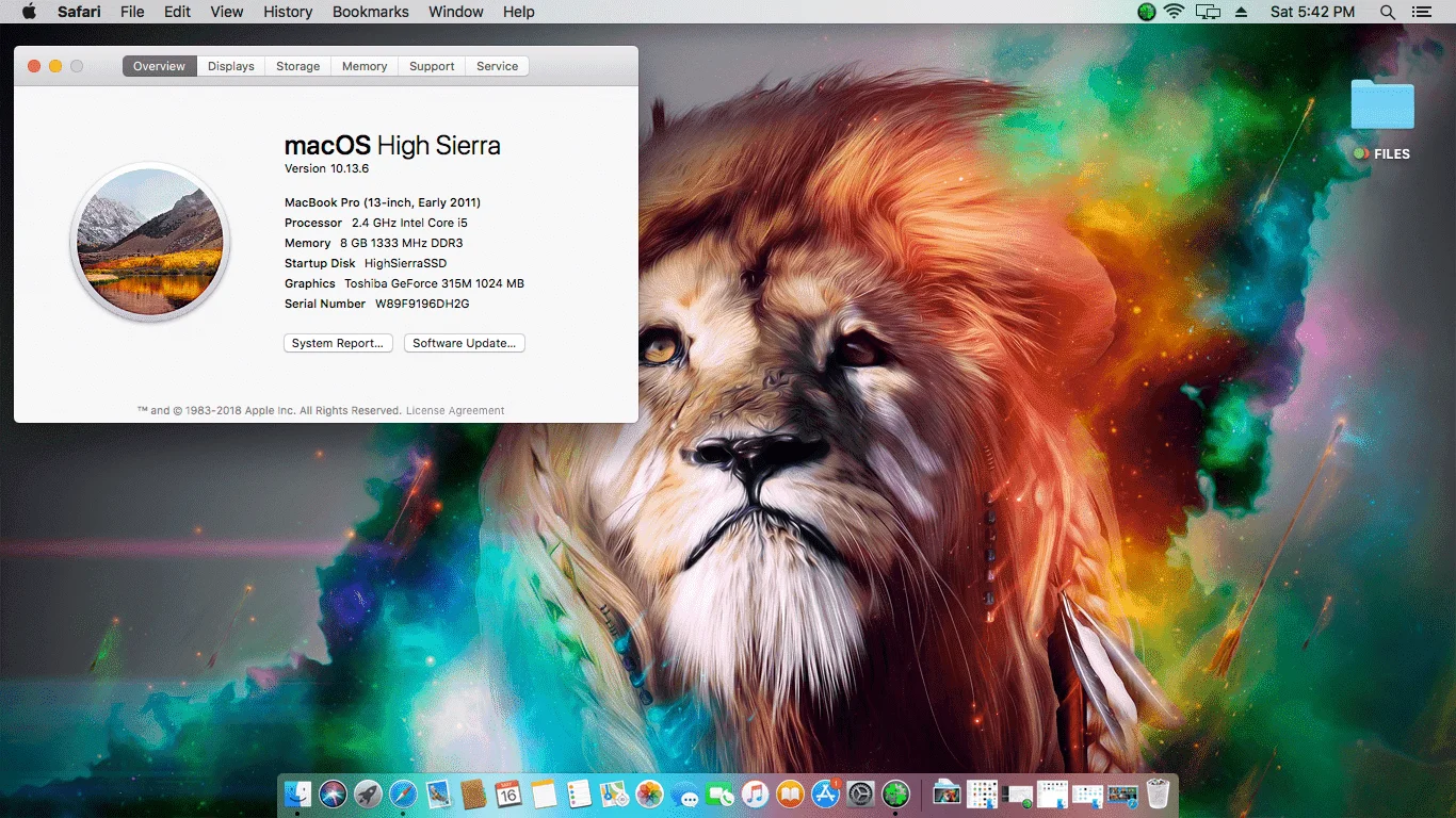

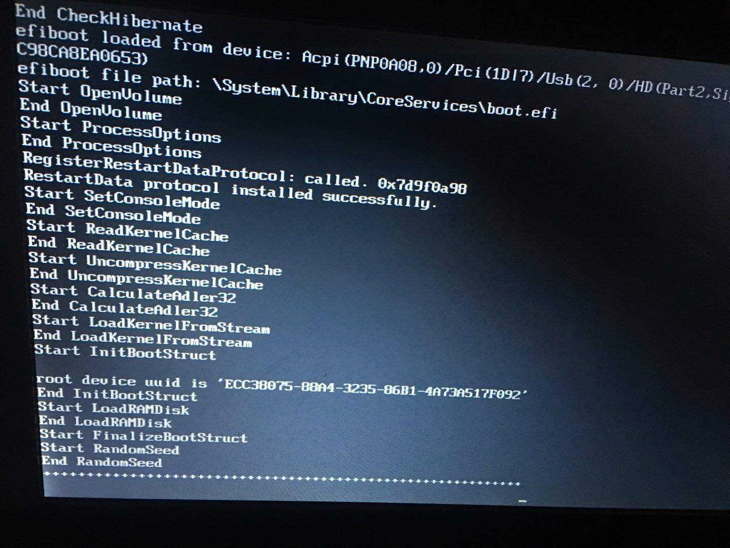

Nahanap ko itong itong thread na ito, gamit ko din olarila High Sierra, swabe sa 10 year old kong laptop na Toshiba C660 :D

ts baka may alternative download ka ng mga files kahit high sierra lang. di ko na kasi maaccess yung mga link na pagddownloadan :'(
