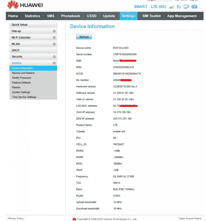

Kapag Connected na kayo sa pocket wifi via usb, use putty or telnet then ang IP Address nya ay 192.168.8.1
  • Change Device Info via Telnet
  • RESTORING DEVICE INFORMATION
Method 1 [ PUTTY OR ANY TELNET CLIENT ]
1. Make sure connected ang pocket wifi via WLAN ng laptop at make sure na pocket wifi lang ang nakaconnect. Kung walang wifi ang gamit, download lang kayo sa phone ng telnet client app.
2. Connect sa 192.168.8.1 gamit ang putty or any telnet client app.
3. Then execute nyo ito isa isa.
atc AT^PHYNUM=IMEI,864056030097081 (original IMEI)
atc AT^SN=XSR7S18620002226 (original SERIAL)
atc AT^PHYNUM=MACWLAN,0CB5277502E7 (original MAC or Custom)
atc AT^SSID=0,"HUAWEI-D822" (original SSID)
atc AT^SSID=1,"HUAWEI-D822-1" (original SSID)
atc AT^WIKEY=0,"86446023" (original PASS)
atc AT^WIKEY=1,"86446023" (original PASS)
atc AT^INFORBU
atc AT^RESET
