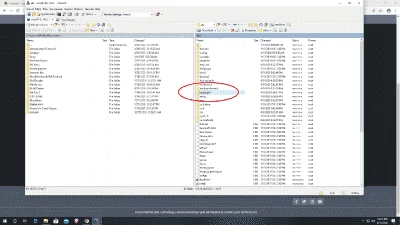

15. Next kapag done kana dyan. Open muna si WinSCP
16. Dapat File protocol mo ay SCP
host name (192.168.1.1) port number 22
17. Username (root) Password (yung Naset mo sa Tplink router mo)
18. Click mo yung naka circle
19. Click etc
20. Find Openvpn folder then click
21. Then makikita mo na yung nakalagay dyan sa openvpn click mo yan then paste mo yung ovpn config mo.
