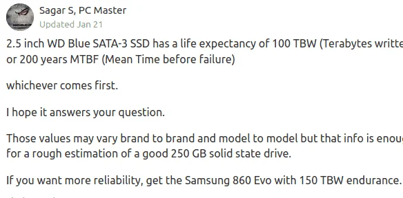

ilan life expectancy ng ssd?

i think if 250gb na ssd kaya naman tumagal ng 5yrs eh
DWPD measures how many times a user can rewrite an entire SSD every day throughout its warrantied lifetime. For example, if the DWPD is 1 on a 200GB SSD drive, and the warranty period is five years, then users can rewrite the entire 200GB daily for 5 years before anticipating failure. Users can also calculate TBW from this number: at 200GB a day over 365 days a year, for 5 years, TBW is 365.

depende sa pag gamit parin yan...may formula online kung pano ma compute....sa sa pic mo na comoute na yan ibig sabihin baka nalagay nya sa formula ang mababang data per year...kaya kung mag copy ka ng 20gb per day mas mababa ang life expectancy...
jan may formula di ko sya masydao ma intindihan
