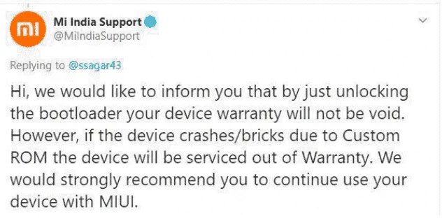

Then you're f**ked situation, since the device is rooted and voided the warranty. You must bring it to MI Authorized Service Center to get it fix for you. This is why i don't stick with a MTK Device, because there's is no testpoint on that thing.
It's not rooted.
Just unlocked bootloader.
But i think it falls in the same aspect that I void the warranty.

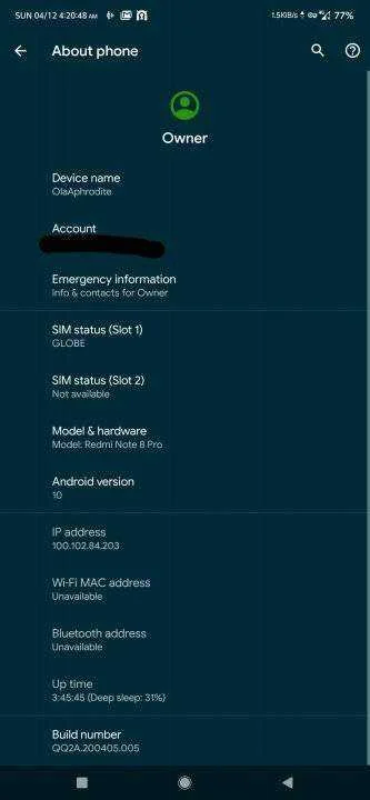

Old thread pero mag cocomment nalang din kao for future note 8 pro users. As of now walang solution sa phone natin na ma unbrick aside going sa service center. Pero kung buhay pa device nyo and still on android 9 miui 11 may need lang kayo i flash na preloader para ma bypass yung authorization sa flashtool and it works, tested by myself. right now using a custom rom and so far mas smooth sa miui.
