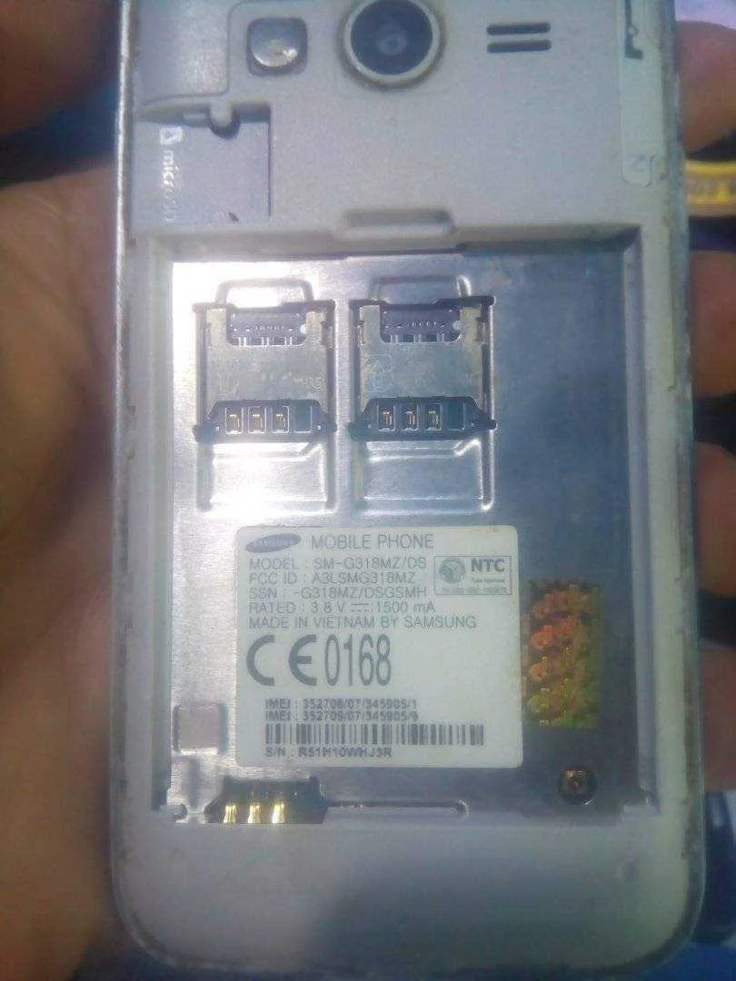

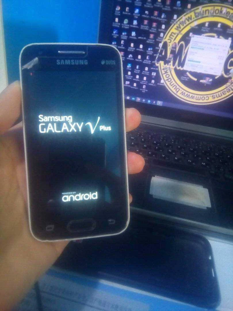

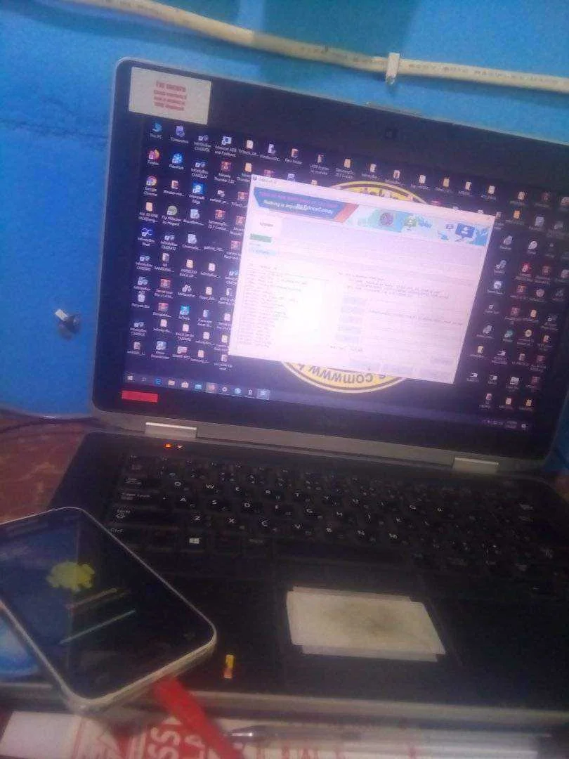

Good and afternoon team nais ko lang eshare sa inyo itong kagagawa ko lang dinala ni costumer sa akin hang on logo ayaw na tumuloy sa menu kaya try ko hardreset na rereset naman succesful kaso hang on logo parin

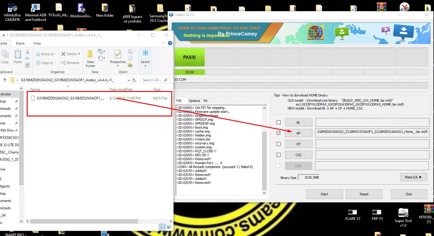

kaya tulad ng dati kay uncle goOgle naman ako humingi ng tulong pero ung pagfaflash nila 4files ung ginawa nila kumbaga full flash ang ginawa nila kaya naicip ko AP files lang kaya ang lagyan ko gamit ang files using oddin latest version para iwas dead sa unit....
model ni phone:
Hang on Logo👇👇
flash AP files lang ilagay using odin...like the picture below here 👉 You do not have permission to view the full content of this post. Log in or register now.

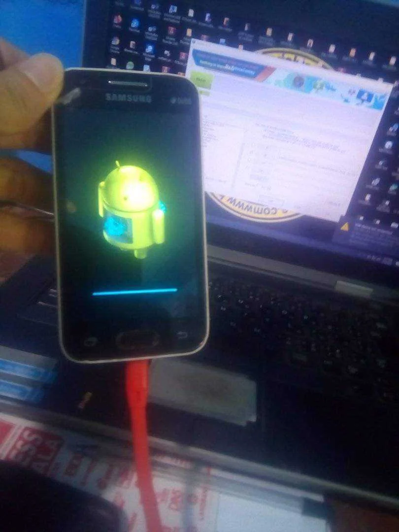

habang nag faflash....

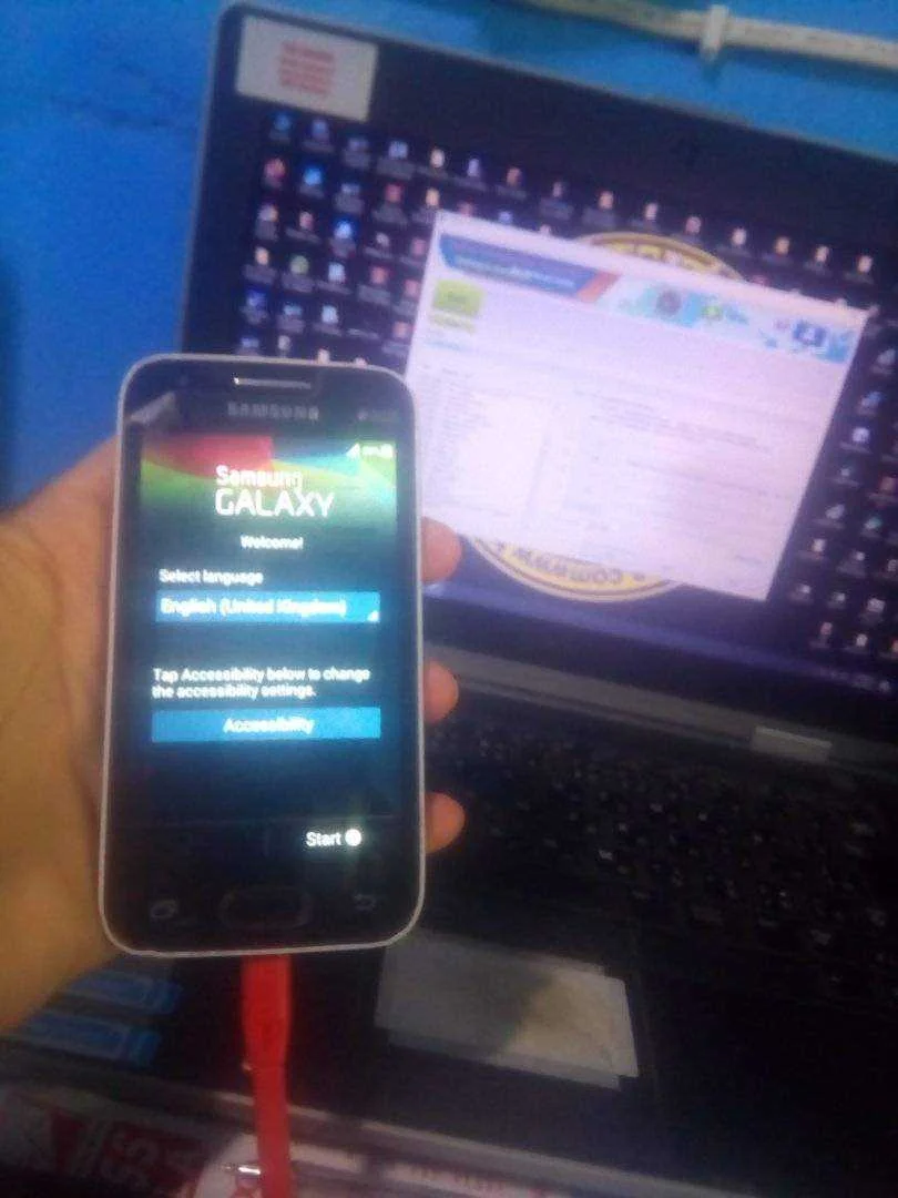

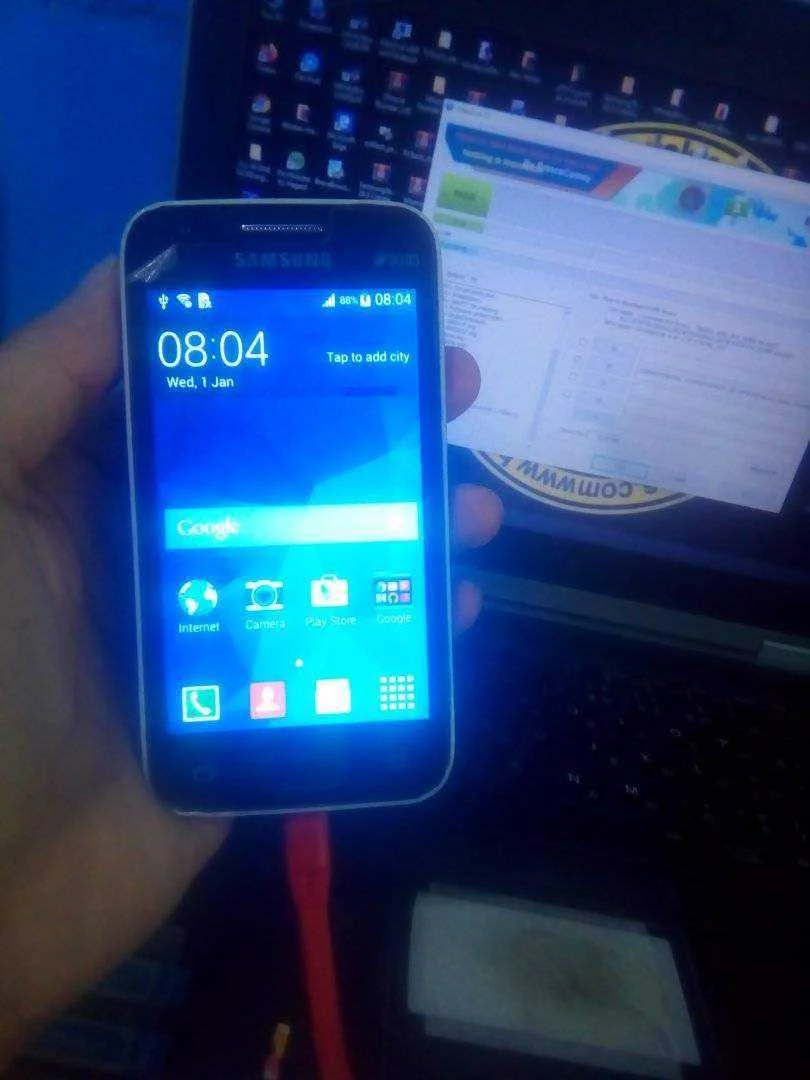

nagrereboot na si phone sinyales success ang flashing...
done ..finish

TRY MUNA HARD RESET F SAME PARIN TIGNAN MO ANO BINARY NYA TRY MO FLASH SAME BINARY AP LANG FLASH MO VIA ODIN TOOLS

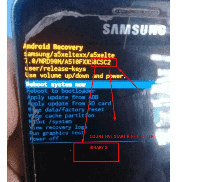

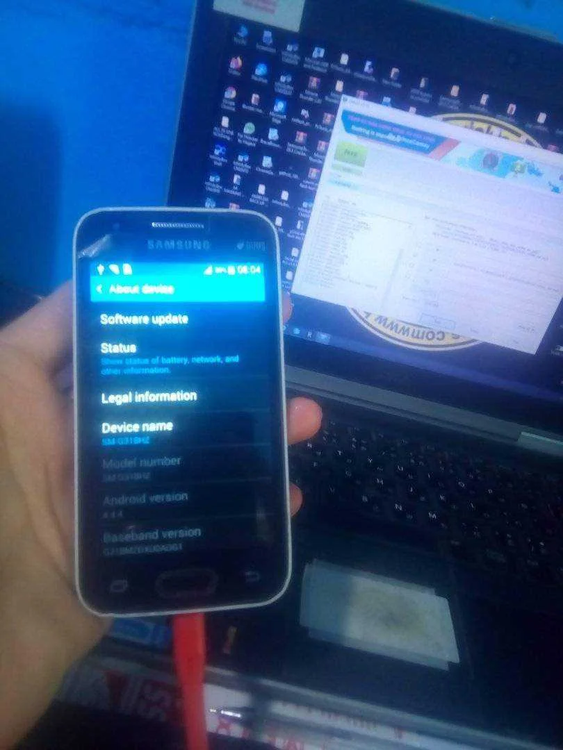

BAGO MO FLASH YONG HAWAK MONG PHONE CHECK MUNA ANO BINARY NYA PARA IWAS ABERYA SA MGA GINAGAWA NUNG UNIT..LIKE SET YOUR PHONE INTO FACTORY RESET MODE BY HOLDING VOLUME UP AND HOME BUTON AND POWER KEY PRESS TOGETHER AFTER THAT PRESS POWER PAG NAG LABAS SI LOGO ANDROID
BINARY NYA..LIKE MY PHOTO EXAMPLE....View attachment 800045
