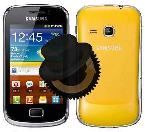

cwm-for-galaxy-mini-2.webp​
This Clockworkmod recovery is built only for Samsung Galaxy Mini 2 with model number S6500. Do not try to flash it on any other device. If you do so, it will cause permanent damage to it.
