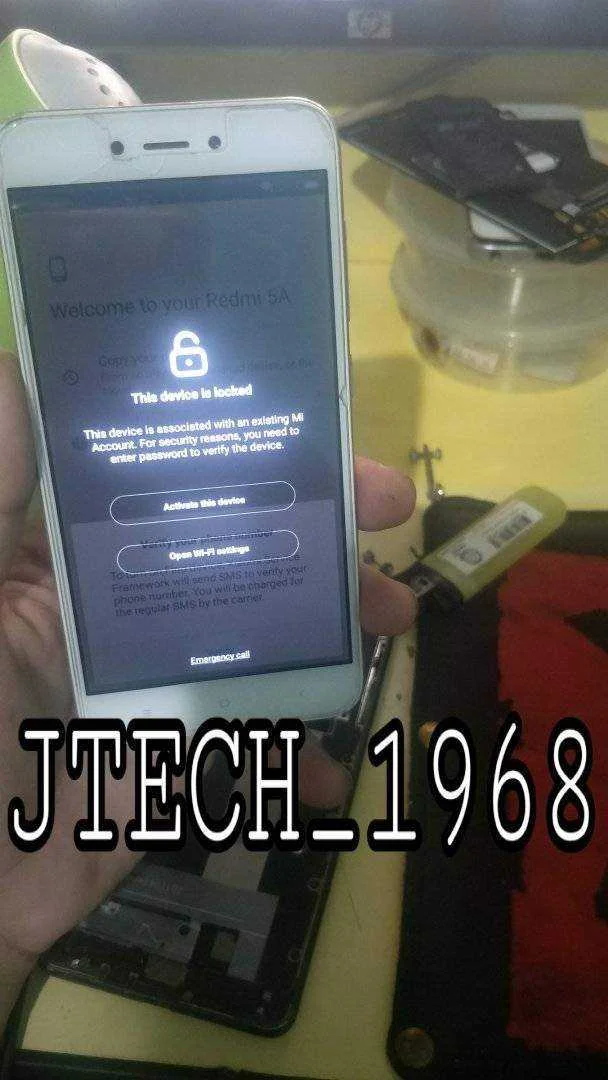

Dinala na daw sa ibang technician sabi daw ng tech 50/50
so napakamot ako at napaisip hahaha ( kc bka abono aabutin ko dito )

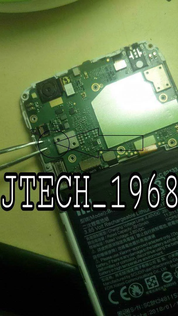

1. ipaalam po muna sa customer na need dissamble ang unit
2. kuha ng twiser then kita naman po sa pic tap nyo ung dalawang dot para mkapag TEST POINT
3. wait nyo lang mag install drivers .. if wala pa kayo Qualcom Drivers hanap nalng po kayo dito sa tahanan natin

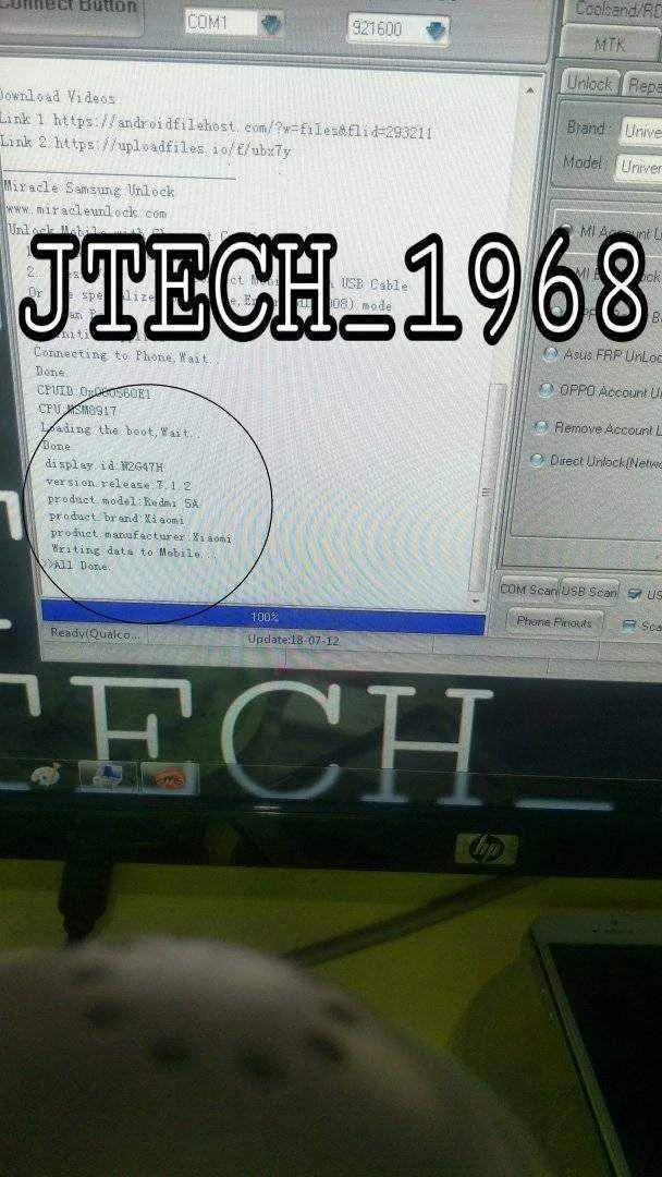

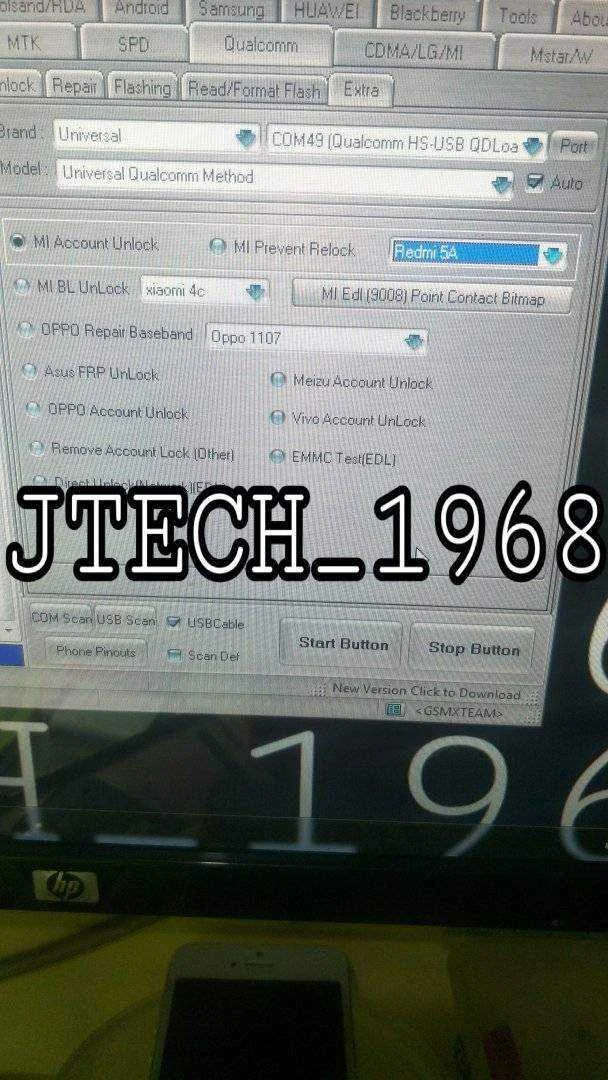

4.open miracle thunder click QUALCOM,EXTRA
5.dapat gnyan na gnyan nkilitaw sa PORT
6.then click start wait nyo lang matapos

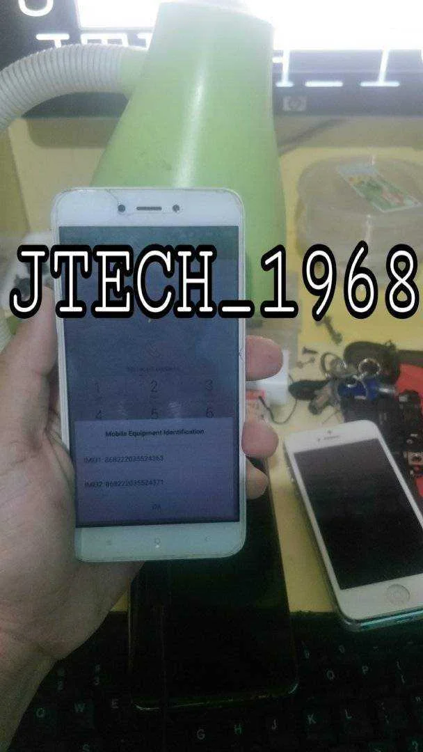

7.then restar nyo na ung unit no need to factory reset
8.Finish product :)

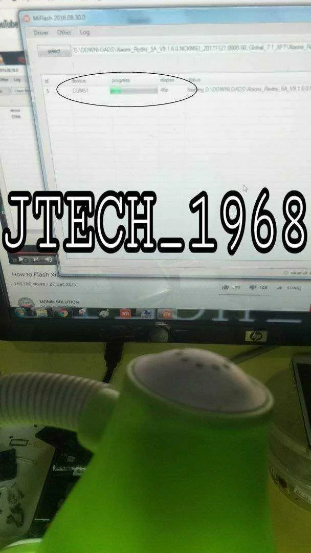

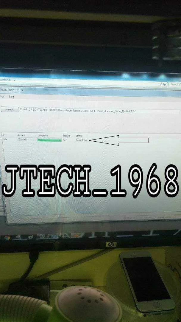

2nd Method Downgrading Firmware
download Firmware and Flashtools
1.
2.You do not have permission to view the full content of this post. Log in or register now.
tested files po yan mga lods wag matakot e flash :)
