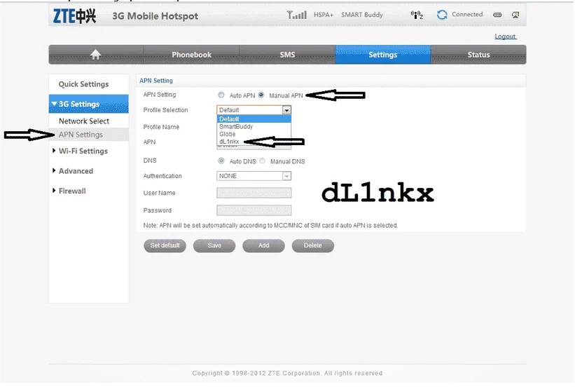

★ ★ZTE MF60 CHANGE APN w/o DEBRAND★ ★

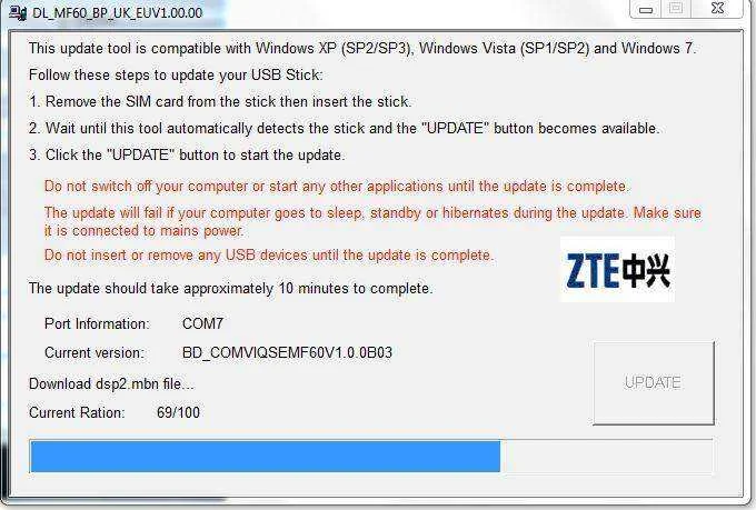

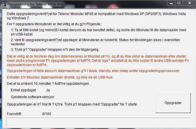

1. "Run As Administrator" telenor firmware tool and wait until the upgrade button becomes available.
2. Close the tool. DONT UPGRADE YET!!

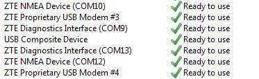

3. Now your windows should found the new devices, it should look something similar to this. Wait until all devices are installed.

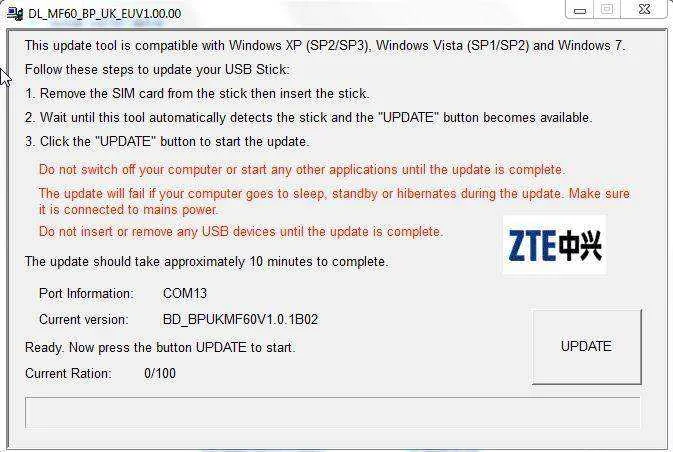

4. Start the official ZTE firmware tool. and pâtch TOOL!

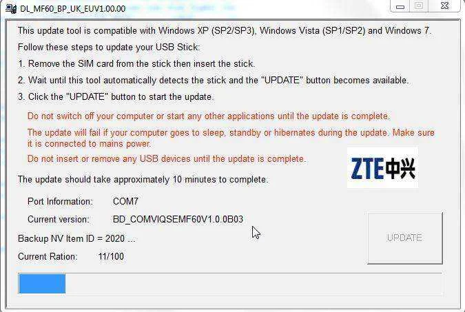

5. Once it is pâtch , next is UPDATE!
6. Wait until it's finished, it will take around 5-10 mins
7. Now you have original ZTE firmware installed! The HOME now is m.home or 192.168.0.1 . The PASSWORD is "admin"
8. To enable USB mode, simply run Telenor tool again and wait until the upgrade button become available. Close the tool. That's it. With the original firmware, the battery indicator is still there even if you're in diag mode.

Note: Before you change your APN , DISCONNECT FIRST!
