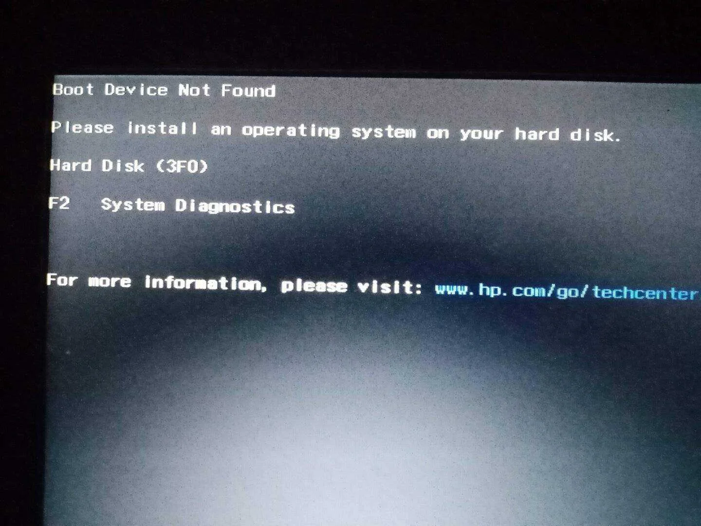

Ito po yung recovery.
Tapos my "click" sound po.
Hindi ko po alam kung paano yung bad sector ng hdd. Hindi ko pa po na tignan physical condition ng hard drive
try mo gawin external yung hdd mo tapos gamit ka ibang pc tapos scan mo using hard disk sentinel dyan mo malalaman life span at kung may bad sector
na try mo na ba to
  1. Turn off your computer.
  2. Boot it by pressing the Power button.
  3. Press the appropriate button to enter the BIOS settings. The key varies depending on the brand of the computer you have. It is best to consult your user manual, but generally, it can be the F12, F2, ESC, or Delete key.
  4. Once you get inside the BIOS Setup Utility, go to Boot Options. Set the hard drive as the primary boot device. Use the arrow key to move it to the top of the list.
  5. Save the changes you made and restart your computer. This should resolve the problem.
na try mo na ba to
Windows 10 po.
Opo na try ko na po yan pati yung ibang option sa boot setup lahat inisa isa ko na po.
Sige po Salamat. I try ko yung suggestion sa itaas po

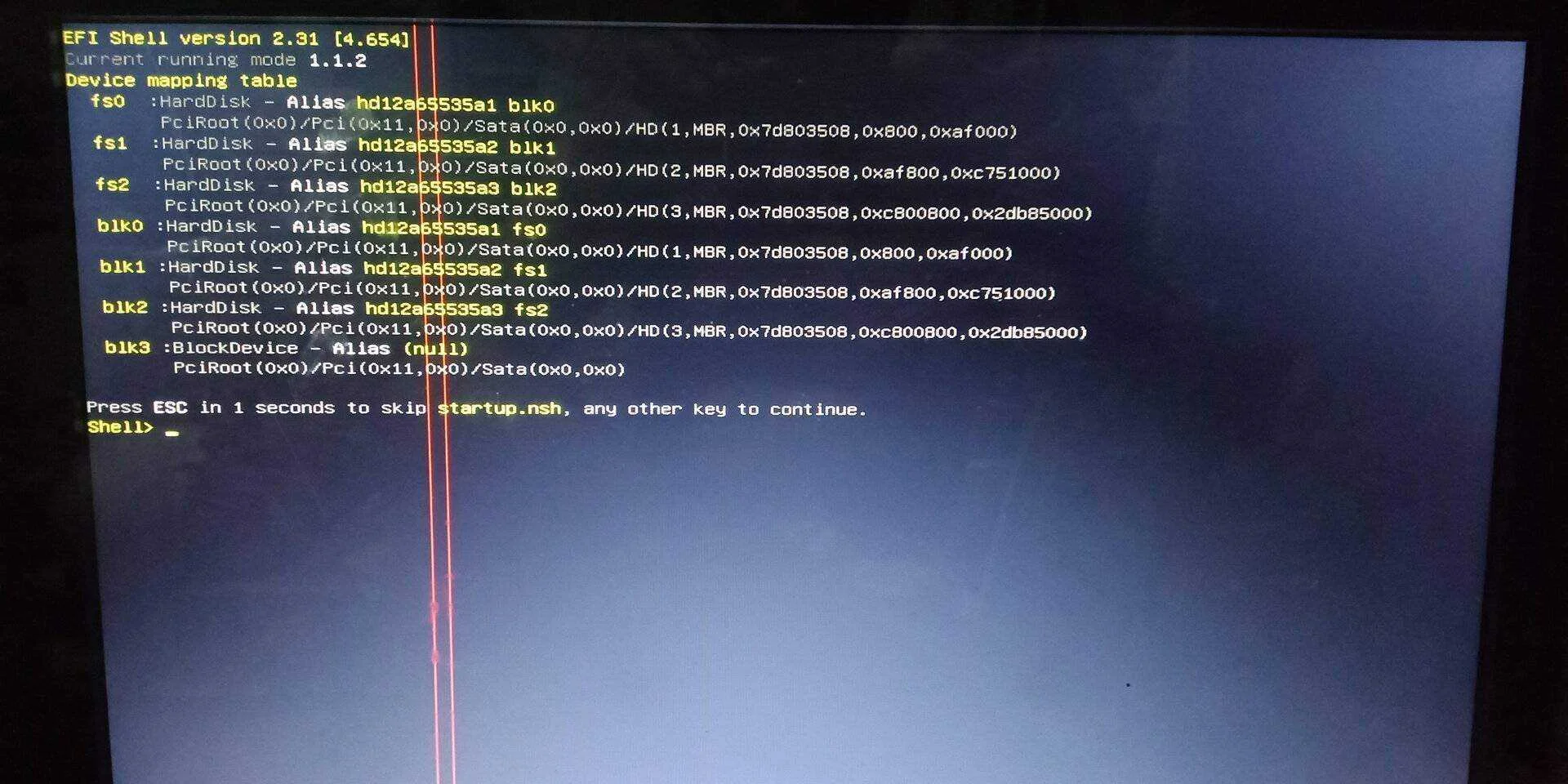

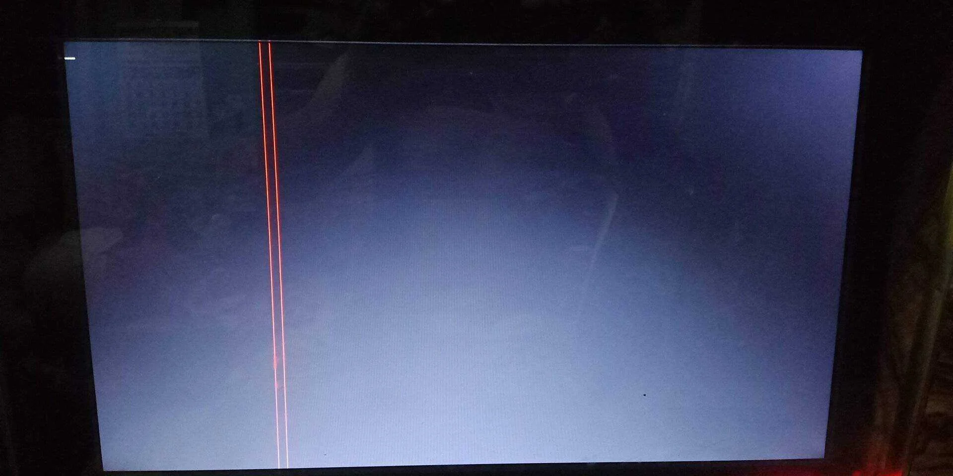

Pag ON ng computer ko, Black screen with steady cursor sa top left ng screen.. Tapos EFI SHELL VERSION 2.31 cannot find map.. Windows 8
A68HM-E33 V2.. MSi military class4 (click BIOS 4).. Tinanggal kona yung RAM pati HDD nilinisan ko tapos inayos ko mga cable/connection if maluwang pero ganun parin.. CPU: AMD A4-7300 APU with Radeon hd graphics.. Pa help po.. 😢😢😢15802979119371960825240.webp1580297980421913083060.webp
A68HM-E33 V2.. MSi military class4 (click BIOS 4).. Tinanggal kona yung RAM pati HDD nilinisan ko tapos inayos ko mga cable/connection if maluwang pero ganun parin.. CPU: AMD A4-7300 APU with Radeon hd graphics.. Pa help po.. 😢😢😢View attachment 771996View attachment 771998
wala ka bang ginalaw sa bios bago nangyari yan?
try mo clear cmos
lipat ng port hdd
