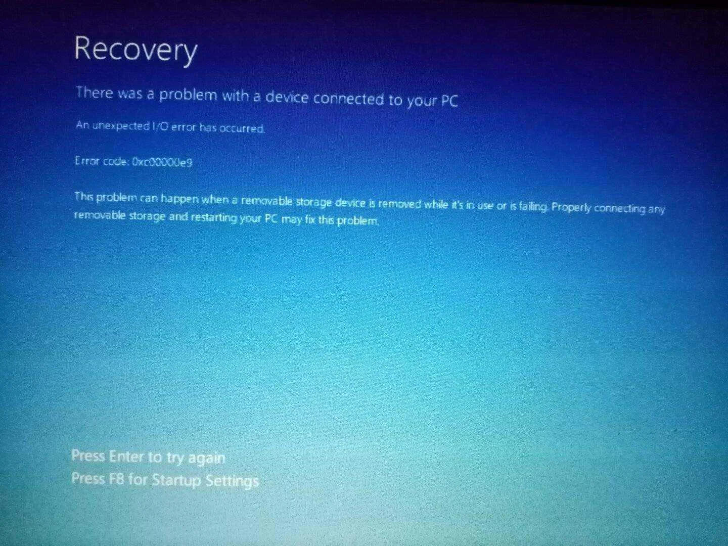

Sir pano po to yung laptop ko na hp pag open sinasbi niya na
boot device not found
Please install an operating system
Nag system diagnostic na po ako na detect naman niya na may had drive. Ito po yung findings niya.
Testing drive: 1
SMART check : passed
Short DST: warning (1: Warning:)
Nag search po ako sa YouTube na try ko na po i enable tska disbale yung legacy support
Nag try ko na din pong ibahin order ng boot option.
Anu po kaya sira nito sir.
Testing drive: 1
Nag search po ako sa YôùTùbé na try ko na po i enable tska disbale yung legacy support
mukhang corrupt na yung OS mo paps, eh pano yung bad sector ng HDD mo wala naman ba??
Ito po yung recovery.
Tapos my "click" sound po.
Hindi ko po alam kung paano yung bad sector ng hdd. Hindi ko pa po na tignan physical condition ng hard drive
