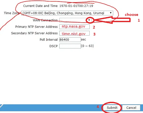

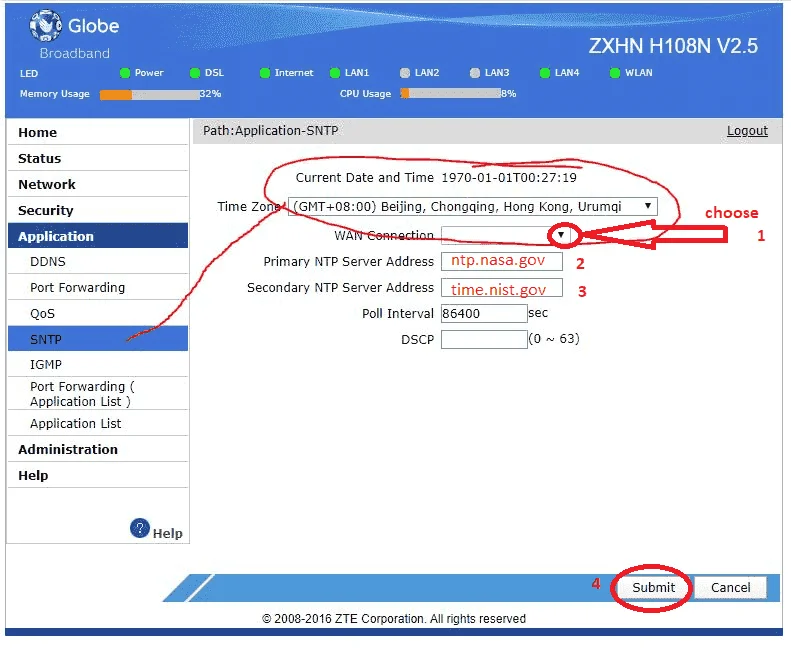

Sa date ata ang problem, hindi cya nagcacalibrate kasi walang server address. Dito kasi kukuha ng data ang router mo para maka set cya ng time. Try this input to your NTP server then click submit.
Pag hindi nag work, pili ka muna sa dropdown ng WAN Connection then same NTP parin then submit. Nasa pic below ang steps:

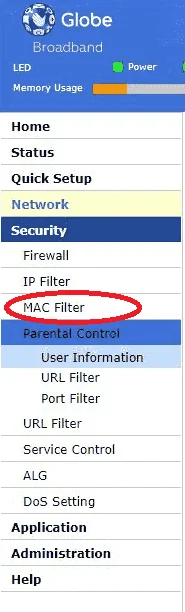

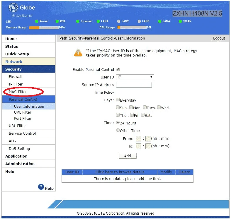

2nd option. for the meantime pwede mo i block using MAC Filter option. Kaso ang downside lng nito is di nkakaset ng time, meaning need mo i block-unblock everyday.
