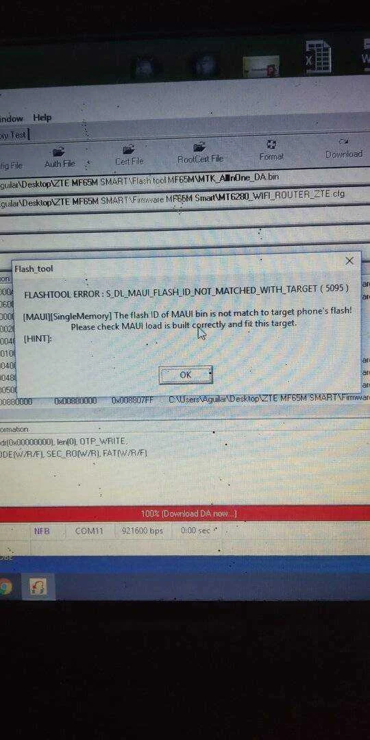

Hello guys share ko lang yung Official Firmware nitong mga ZTE MF65M na Pocket Wi-Fi.
Here's the Link:
For SUN
For SMART
FOR GLOBE
Ito ang Tutorial:
Step 1:
Extract all files.
Step 2:
Find "MTK_DRIVER_ext" folder in the location where you extracted files, and open it.
Step 3:
Run "DriverInstaller.exe" then select "Install Drivers" in 3 RadioButton then click start Button and wait.
Step 4:
After Finish Installation , exit and open the "Flashtool MF65M" Folder then run the "Flashtool.exe". then click the scatter file.
Step 5:
Select the Firmware that located on where you extract all files. Find "Firmware MF65M GLOBE" Folder if your ZTE is Globe...
Step 6:
Find scatter file, (you can find easily beacuse 1 extension file will show), then Click Download.
Step 7:
Make sure your ZTE MF65M is turned off. then Connect in the USB Connectors and wait until FInish.
After That you are now the official ROM.
I hope you like this post. Thanks for y'all.
