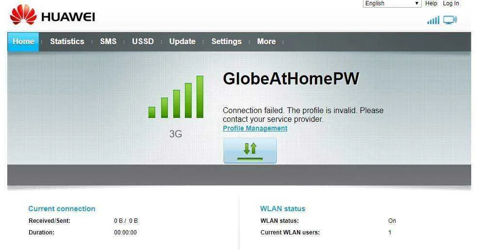

Sa mga nag kaka-error ng ganto 936 Modems
Connection failed. The profile is invalid. Please contact your service provider.
Eto po simple FIX
First Option
1. Access WEBUI
2. APN: internet.globe.com.ph
3. Change Network Profile to AUTO/AUTO
4. Restart
Second Option
1. Changed to NEW IMEI using app via LAN Cable
2. Access WEBUI
3. APN: internet.globe.com.ph
4. Change Network Profile to AUTO/AUTO
5. Restart
Back to normal na po lahat, makaka internet kna ulit --
Note:
I switch to 3G in my location kc hindi congested, yet the following day I received this ERROR na in which akala ku blocked ang At Home sim ku (purchased online). While reading here sa phcorner, I figured out na hindi nag bblock ng at home sim si GLOBIBO. Perhaps, kinalikot ku ang modem.. at na fix ang error..
Changed the IMEI na rin para smooth just in case
:LOL:
ganito din sakin boss gusto ko kasi 3g lock mas malakas 3g d2 samin kaso invalid profile talaga pag homewifi sim gamit ko pero pag normal sim connected nman sya sa 3g..meron cguro talaga apn para sa 3g nang homewifi.
