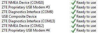

**Install MF60 driver**
++Please Remove the SIM++
0. Connect the Modem using the "USB wire"

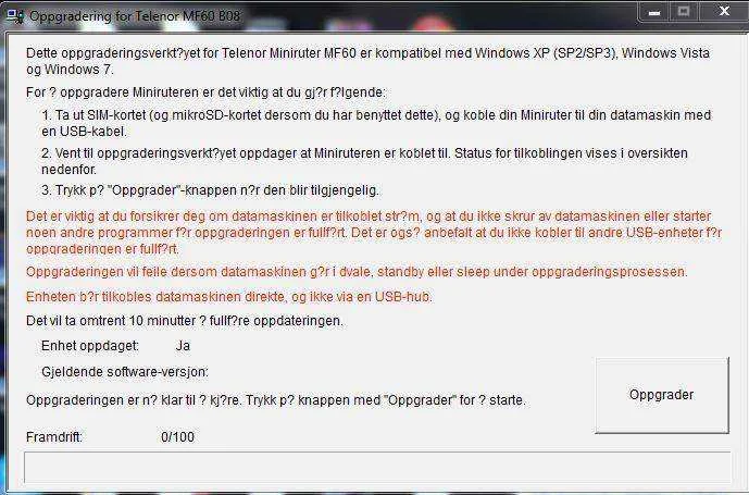

1. "Run As Administrator" telenor firmware tool and wait until the upgrade button becomes available.
2. Close the tool. DONT UPGRADE YET!!
3. Now your windows should found the new devices, it should look something similar to this. Wait until all devices are installed.

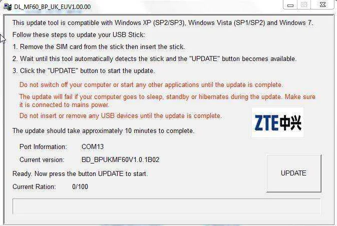

4. Start the official ZTE firmware tool. and ρá†ch TOOL!

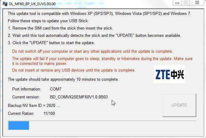

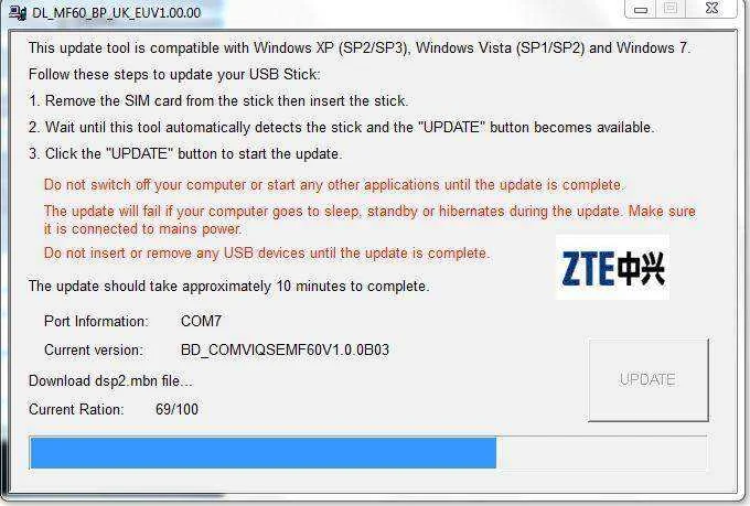

5. Once it is ρá†ch , next is UPDATE!
6. Wait until it's finished, it will take around 5-10 mins
7. Now you have original ZTE firmware installed! The HOME now is m.home or 192.168.0.1 . The PASSWORD is "admin"
