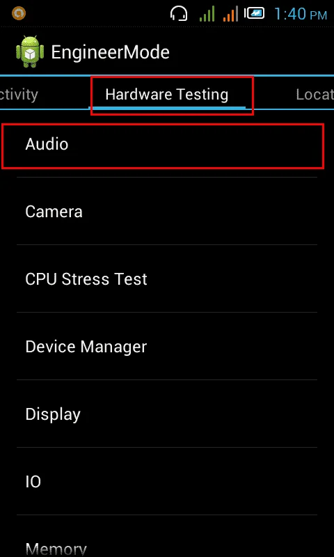

step1: dial ##3646633##
step2: scroll to the right hanggang mapunta ka sa hardware testing.

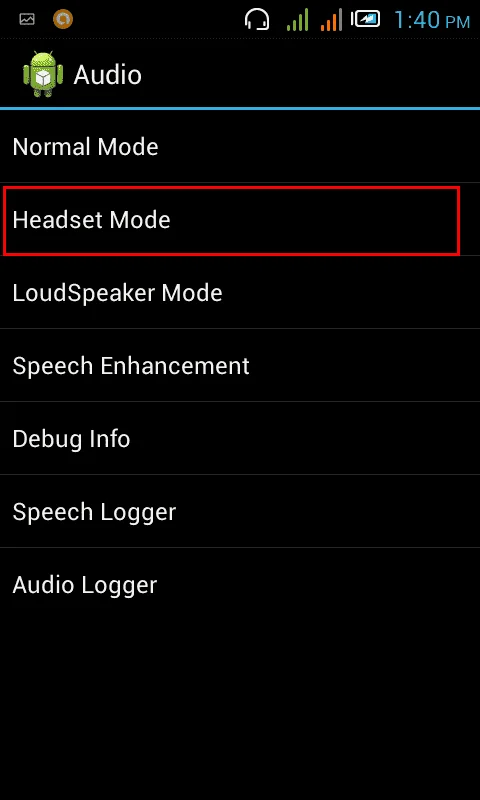

step3: select Audio

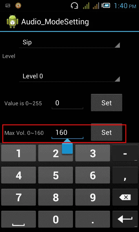

step4 :select headset mode
step5: change Max.Vol value to 160 and press set

Thank you sir! It worked.
