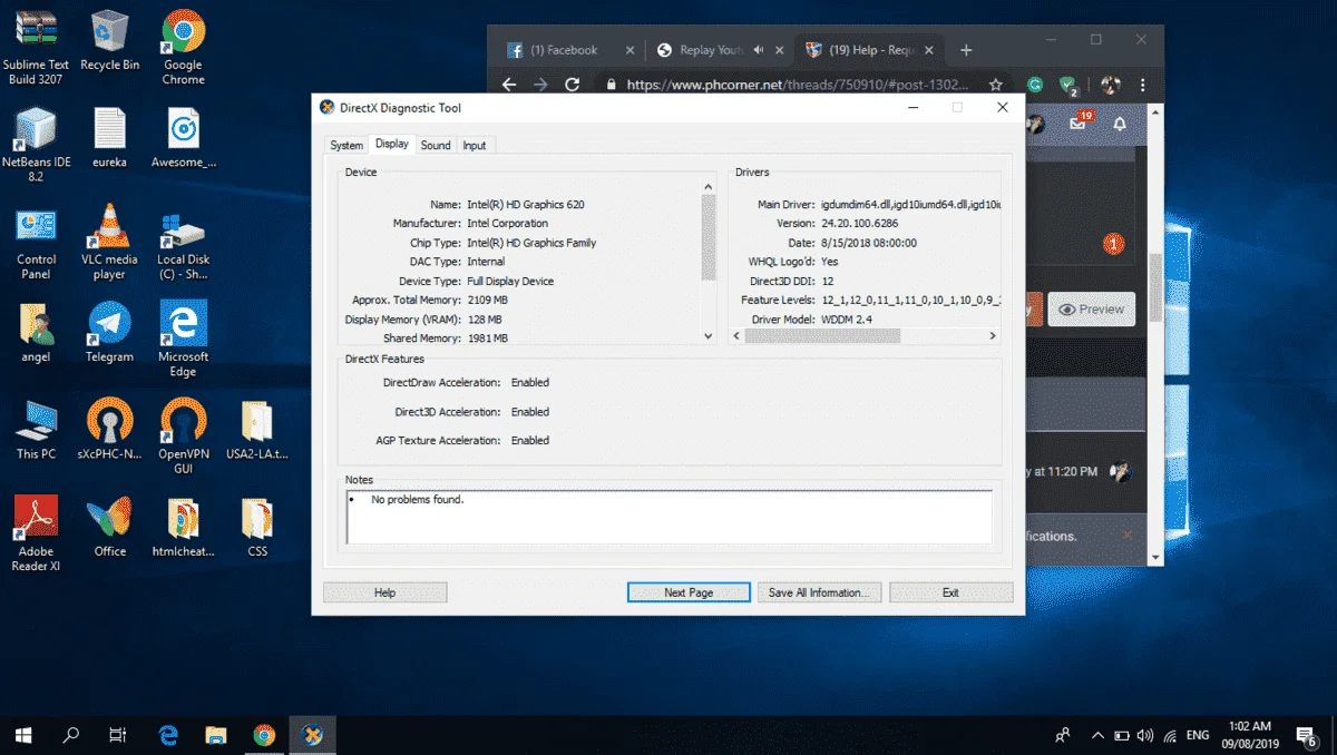

🔒 Closed pwede po ba ma overclock yung gpu at cpu sa windows 10
as far as I know, pwede i overclock kahit naka locked ang CPU, kaso yung performance is hindi mahahalata at mas risky kaysa sa typical na overclock...
and sa integrated GPU , pwede pero makaka dagdag lang yan sa heat nung CPU na mainit na dahil sa overclocking..
if your planning to overclock, make sure naka unlocked ang CPU, meaning... kung intel ka.. dapat may "K" sa name nung CPU .. kung amd naman.. halos lahat pwede i overclock..
tapos need mo ng cooler syempre ..
pero kung natatakot ka na lumiit ang lifespan ng CPU, wag kana mag overclock.

Sige po anu ba nagagawa ng overclocking po?
Overclocking is configuration of computer hardware components to operate faster than certified by the original manufacturer, with "faster" specified as clock frequency in megahertz or gigahertz. Commonly operating voltage is also increased to maintain a component's operational stability at accelerated speeds.
Source: wikipedea..
Source: wikipedea..
Salamat po mataas din cpu neto 2+ghz kaya di malag
Dagdagan mo lang ng 5 to 10 MHz, tapos stress test. Kapag walang error, dagdagan mo ulit.
Kapag pumalya, dagdagan mo ang CPU voltage ng 0.005v hanggang maging stable, tapos stress test ulit.
Pero 'wag mo asahan na mataas ang overclock na maabot mo sa Laptop, mahina lang kasi cooling system.
