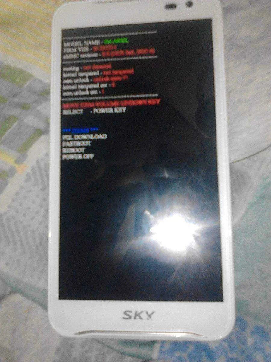

Turn off the phone, press the 3 button keys and select fastboot mode.( Hold nyo yung Volume UP/Down tapos Power pra mag FastBoot)
pag naka fastboot na Plug the cable connection and Open A830L_JB_Recovery Folder and run Install Recovery from Fastboot.bat(Double click)
Wait then enter
Phone will run into CWM Recovery 6.0.3.1 (phone has now in recovery mode)

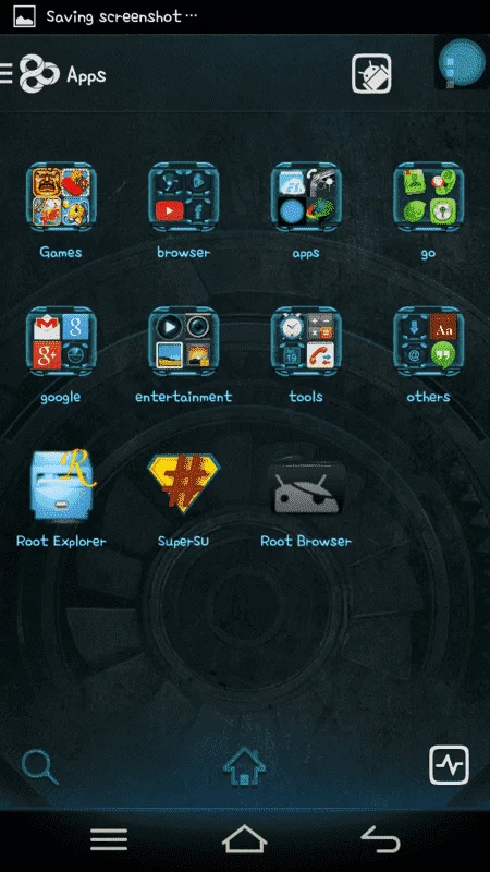

Reboot your phone and phone have been root.
sana nakatulong.
Credit sa Owner ng file and me Sa translated tool
14135910.gif​
Any help Po Pano mag Hard Reset sa Sky vega Racer 2 korean Version Di ko po maayos ee helpp plss
Ano Po Dapat Kong Gawin Para Mareset To .. Di ko po maayos Ee Help po
