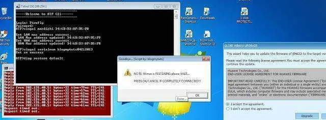

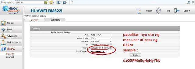

How to connect?

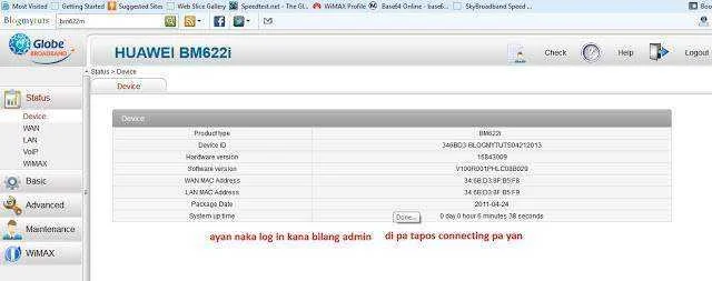

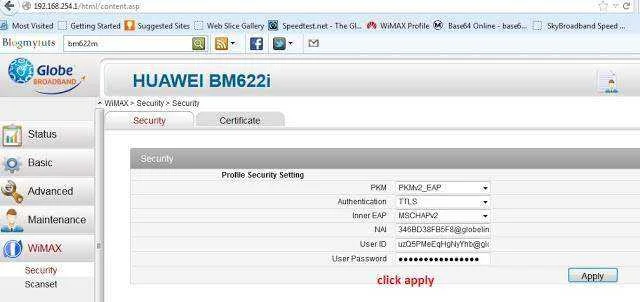

You must have generated user ID and pass of 34 and C8 from a Wimax modem 622m or wimax tool 3.0 ni yyyxyyx makikita yun sa tool setting then web/extra setting.
Example:
Mac: 34:6B:D3:8F:B5:F8
User ID: uzQ5PMeEqHgNyYhb
Serial:550548988956454656

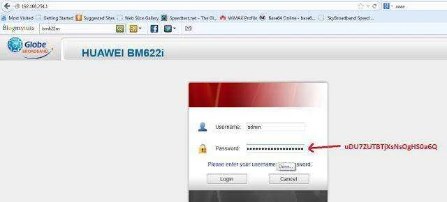

Admin Password:uDU7ZUTBTjXsNsOgHS0a6Q
NOTE: Normal admin pass for 2010 to edit security use password generator NO Need to change Serial on 2010

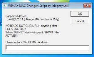

NOTE:For bm622i 2011 You must change Serial number to use my admin pass generated to edit security settings.
NOTE: For bm622 2011 use wimax tool 6.5 ni charles to generate your admin password
Sample Mac and Serial Change

622i Mac Changer +Serial Included

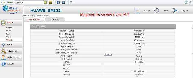

pero pag ako nag coconnect ng 622i 2010/2011 with new series, 1 click connect lang sa wimax tool v3.0, rekta change and connected na yun, mapapansin molang kahit new series si mac, ang admin password nya ay Old Series kagaya neto for example "2008vkjafKJHgf" pero and security settings nyan ay New Series parin ;)
Marami din po kasi nagtatanong sakin sir Lift,.hindi naman kc nila alam gamitin yun,.mas madali na nga hihihi,.
Oo nga e, di pa siguro nila nattry, once kase na tinry ko, successfully connected akala ko talaga kelangan pa mag generate ng password, pwede din palang rekta na :LOL:
ganun gusto ko yung rekta na 1 click lang sa v3.0 22i 2011
Slamat Dito TS :D napagana ko din yung mga new series kaka upgrade ko lng kasi nang 2010 ko to 2011 :D
