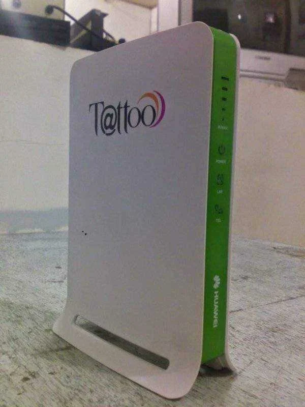

🔒 Closed How to fix bm622m 169 ip (remoted)
AnotherWays
Honorary Poster
FOLLOW THE INSTRUCTIONS
1.set static IP from the last FIRMWARE bago ma REMOTE EG, GREEN PANGET IS 10.1.1.254 OR 22m 2012 192.168.254.1 basta default ip ng last FIRMWARE na gamit niyo
2.OPEN WINSPREADER/CHOOSE EXACT FIRMWARE NA GAGAMITIN NIYO SAKIN I USE GP
3. start WINSPREADER
4.PLUG in WIMAX
5.after 1 minute UNPLUG WIMAX/ after 10 seconds PLUG ulit.
6.ito na ang trick
7.observe every 2 minutes kung mag didisco ang signal lights kung hindi every 2 minutes UNPLUG/PLUG ang WIMAX until mag disco, siya be patient.
minsan may lalabas na error na "WINDOWS HAS DETECTED AN IP ADDRESS CONFLICT" ibig sabihin pasok na yung FIRMWARE kaya ngiti kana konti, pero minsan wala lumalabas na ganyan pero pumapasok yung FIRMWARE
8.NOTE:kapag lumabas yung "WINDOWS HAS DETECTED AN IP ADDRESS CONFLICT" set niyo na IPV4 sa OBTAIN AN IP ADDRESS AUTOMATICALLY.
NOTE:pag 22m ang FIRMWARE na pinasok mu dapat 1,4and5 SIGNAL LED'S ang iilaw pag GP naman pag tapos na ang FIRMWARE uploadind parang tulala bukas lahat ng signal led's
9.then disable network adapter/enable
go to CMD and IPCONFIG
look kung ok na ang ip and accesible na ang Gui
pag accessible na gui telnet agad use this commands
telnet 192.168.254.1 OR 10.1.1.254 OR LAST FIRMWARE TELNET PASSWORD
Firefly
$P4mb1h1r4N4m4nT0!!
apinfo > /etc/default.cfg
sncfg commit
sncfg reset
sncfg default
reboot
NEXT -> HARD RESET
NOTE: may ewmoted na 22m na di na magagawa, yung signal led ilaw lang ng ilang ayaw pumasok ng firmware at auto disable ang lan after 1 min tapos wala na.
