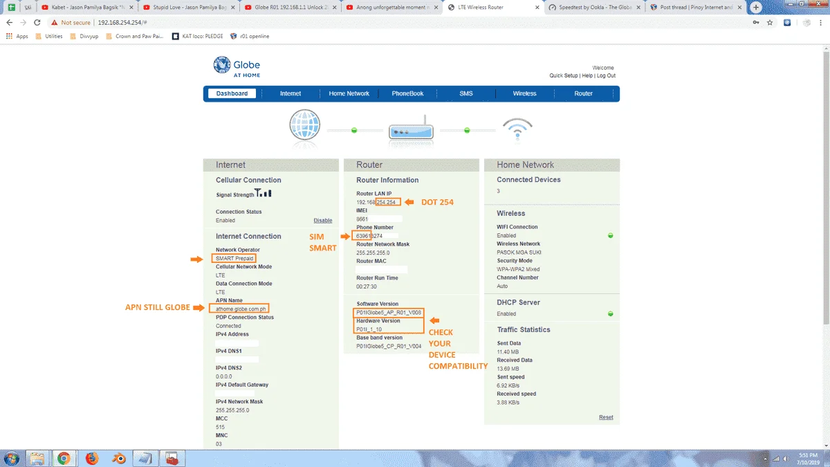

SHARE KO LANG MGA PAPS, SINCE ILANG ARAW DIN ANG PINURSIGI KO DITO AT ILANG EXPERIMENTO DIN ANG GINAWA KO MULA SA SARI-SARING TUTORIALS.
ANG MODEM KO PO AY R01 AND DOT 254 PERO HINDI PO GUMAGANA SAKIN ANG METHOD NG WINSCP AND PUTTY (USERNAME: ROOT/PW: PASSWORLD) DAHIL SA LUMALABAS NA SECURITY BREACH AND ACCESS DENIED. KAHIT DOT 254 ANG MODEM KO, .BIN PA DIN ANG CONFIGURATION SETTINGS NA HINIHINGI NYA AT SINUBUKAN KO NA PO BOTH DOT 1 AND DOT 254 EVEN RENAMING NG FILE EXTENSION NG DOT TAR TO DOT BIN PERO HINDI TALAGA GUMANA. KAYA NAISIP KONG SUBUKAN OLD SCHOOL TUTORIAL NA GINAGAMITAN NG USB DATA CABLE AND MARVELL MIFI TOOLS AT NATUWA AKO NG GUMANA SYA! NAKA-ATTACHED PO DITO ANG MGA SCREENSHOTS KO PERO PARA IWAS RED LIGHT KAYO, MAKE SURE NA MATCH PO ANG IBANG DETALYE NG DEVICE PRA MAKASIGURADO NA MAGING COMPATIBLE PO ITO SA R01 NYO. KATULAD NG NAKUHA KONG MODEL NA R01 PERO DOT 254 PERO SA CONFIG SETTINGS, DOT BIN PA DIN AT HINDI DOT TAR ANG NEED NA FILE. NAISIP KO NA BAKA ITO PA DIN ANG MGA LUMANG DOT 1 MODEMS PERO PRA LITUHIN AT HINDI PAKIALAMAN, BINAGO NILA NG DOT 254 PERO LUMA PA DIN ANG FIRMWARE. ANG SA AKIN PO AY 2017. NAGTAKIP LANG PO TAYO NG ILANG MASESELANG DETALYE AT MAHIRAP NA BAKA MAY TUMATAMBAY NA TAGA GLOBE DITO AT I-BLOCK ANG ROUTER NATIN.
MAHALAGA: PAKI-CHECK PO MUNA KUNG TUGMA ANG SOFTWARE AT HARDWARE VERSION NG INYONG R01 SA AKING GINAMIT. ANG METHOD PO NA ITO AY MAAARING GUMANA O HINDI SA MGA PILING DEVICES.

Share ko lang mga paps, since ilang araw din ang pinursigi ko dito at ilang experimento din ang ginawa ko mula sa sari-saring tutorials.
Ang modem ko po ay r01 and dot 254 pero hindi po gumagana sakin ang method ng winscp and putty (username: root/pw: passworld) dahil sa lumalabas na security breach and access denied. Kahit dot 254 ang modem ko, .Bin pa din ang configuration settings na hinihingi nya at sinubukan ko na po both dot 1 and dot 254 even renaming ng file extension ng dot tar to dot bin pero hindi talaga gumana. Kaya naisip kong subukan old school tutorial na ginagamitan ng usb data cable and marvell mifi tools at natuwa ako ng gumana siya! Naka-attached po dito ang mga screenshots ko pero para iwas red light kayo, make sure na match po ang ibang detalye ng device pra makasigurado na magiging compatible po ito sa r01 nyo. Katulad ng nakuha kong model na r01 pero dot 254 pero sa config settings, dot bin pa din at hindi dot tar ang need na file. Naisip ko na baka ito pa din ang mga lumang dot 1 modems pero pra lituhin at hindi pakialaman, binago nila ng dot 254 pero luma pa din ang firmware. Ang sa akin po ay 2017. Nagtakip lang po tayo ng ilang maseselang detalye at mahirap na baka may tumatambay na taga globe dito at I-block ang router natin.
Mahalaga: paki-check po muna kung tugma ang software at hardware version ng inyong r01 sa aking ginamit. Ang method po na ito ay maaaring gumana o hindi sa mga piling devices.
**pagpasensyahan na po at bago po ako dito, medyo nangangapa pa. kaso di ko ma-edit yung all caps, kaya post reply nalang. maraming salamat po.

yes sir unlocking lang po sya and hindi debranding, pero napaka bilis lang po nya isetup kasi no need ka na mag install, few clicks lang on mifi basta naka-kabit ang USB data cable. and count to think of it, hindi naman tayo madalas mag papalit ng sim especially kung may mahaba tayong promo period :)
