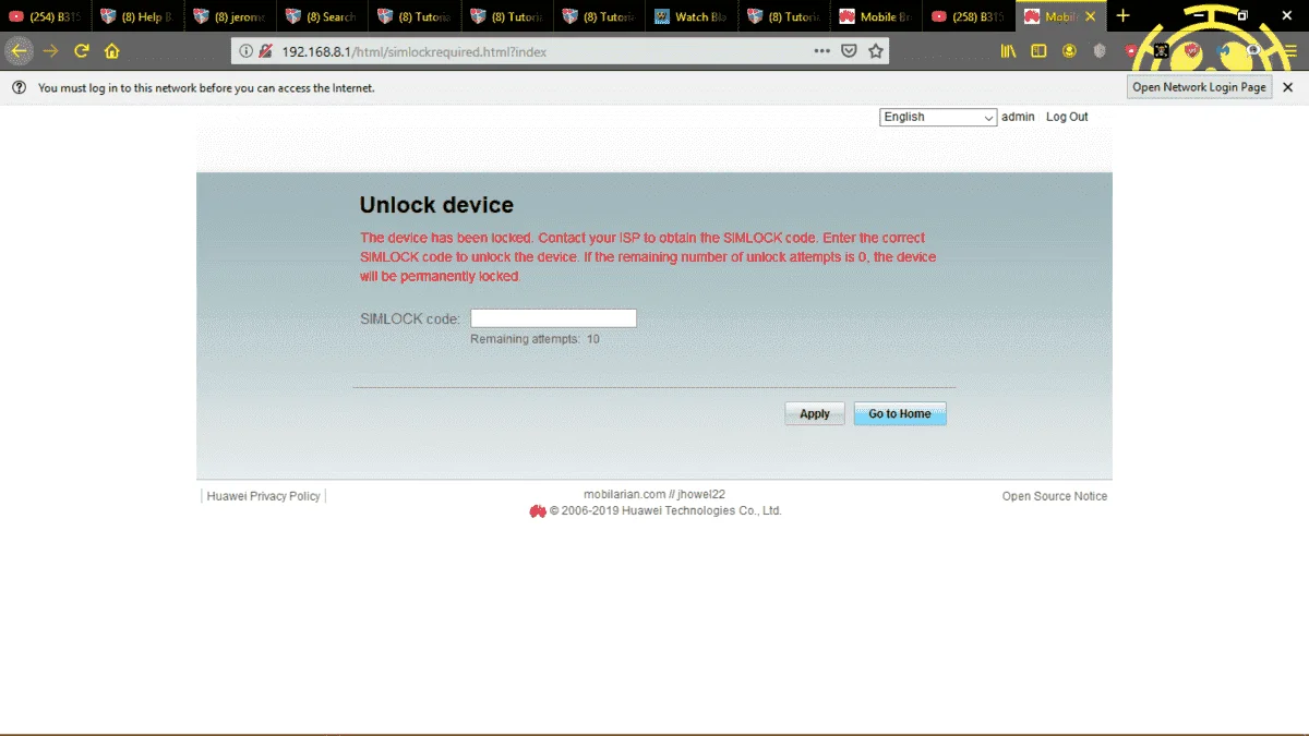

Mga master patulong po ako. Ndi kona po ksi alam gagawin ko.
globelocked 936 modem with antenna. 4-5bars lte
acer laptop 64bit windows 10
So ganito po yun story.
kaka-openline ko lang po using the tutorial po ni boss Jhowel sa Youtube (You do not have permission to view the full content of this post. Log in or register now. .com/watch?v=T_0HCj03x0E)
I did it while watching the video para maging okay(sana)
1. installed all the drivers (except for 1 error di yata compatible sa win10)

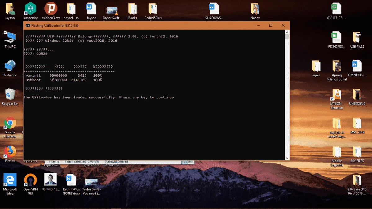

2. DEBRANDING: balong usb loader installed successfully (refer to the 1st pic-screenshot 275)

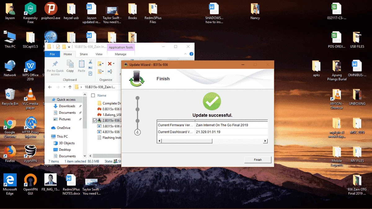

3. Change firmware to Zain Internet On The Go Final 2019 (refer to the 2nd pic-screenshot 279)

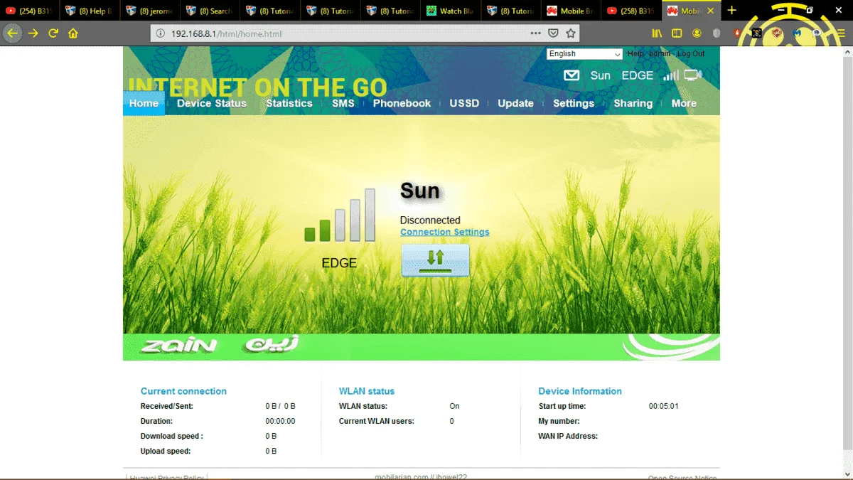

4. Openline it using B315s-936 1-Click Openline Unlocker (refer to the 3rd & 4th pic-screenshot 281,285) as you can see SUN na po nakalagay na sim at nababasa nman
5. Installed Additional Parameters
All were successful
6. I went to 192.168.8.1 too see if its all succesful and yes its okay. but its just in EDGE connection (refer to the 4th pic-screenshot ,285)

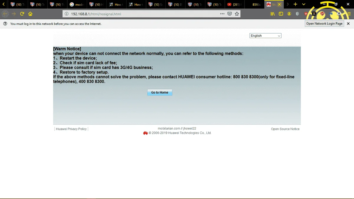

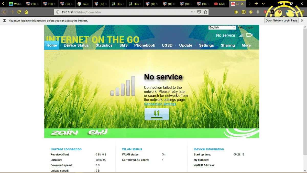

7 I change it to 4G then 3G so nangyari is Red Light/No-Signal/No-Service(refer to the 5th & last pic-screenshot 287,288)
8. Even tried to use different sims: Postpaid globe, prepaid smart,sun,globe but still not working po.
Ive read and search all over phcorner, google and yt
May nabasa akong gagamitin yata NVRAM eraser but still I dunno what to do. baka masira ko lang lalo.
Paturo po mga master. Sana matulungan nyo ko. thanks
