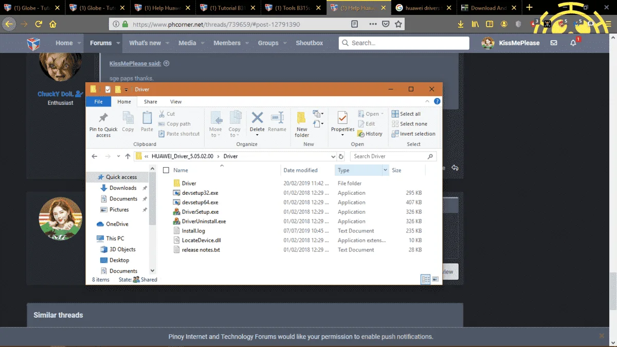

1. installed all the drivers (except for 1 error di yata compatible sa win10)
2. DEBRANDING: balong usb loader installed successfully (refer to the 1st pic-screenshot 275)
3. Change firmware to Zain Internet On The Go Final 2019 (refer to the 2nd pic-screenshot 279)

BTW about dun sa Driver na di mainstall for windows 10 64bit like me.
Dinownload kopo un "Huawei Drivers ni Master Jerome Laliag"
So I think nakatulong din. (Nasa fb ni master)
Then Clear NVRAM
Tpos Reflash ulit lahat.
