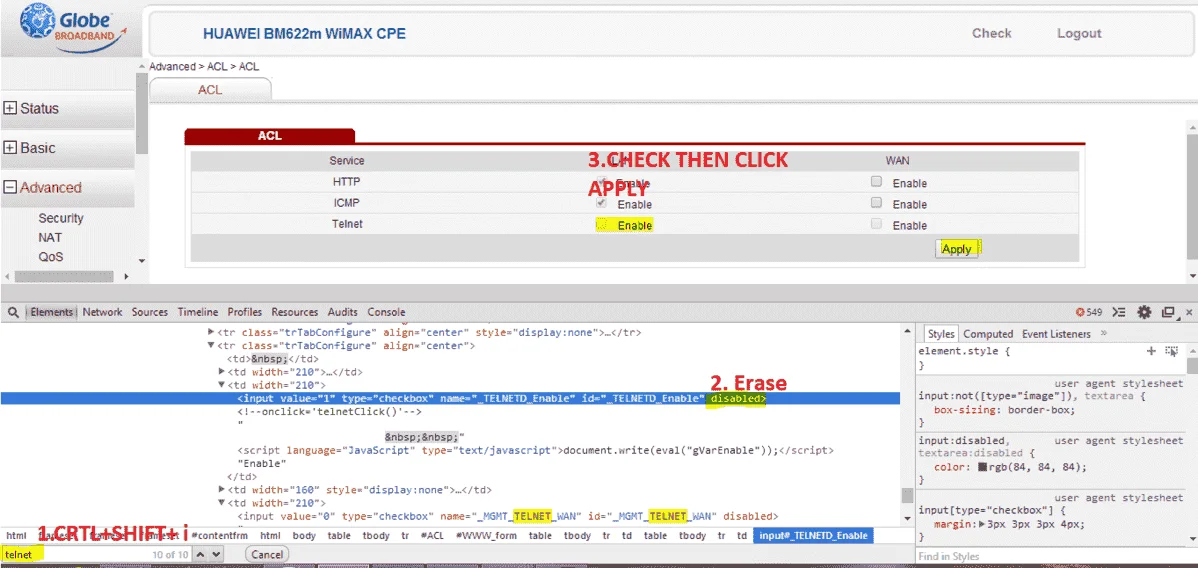

Good pm, paano ba maenable ang telnet sa bm622m 2012, downgraded from bm623m, ndi ko kasi maccess advance tab, ntry ko na un http:192.168.254.1/advanced/acl.html ntry ko na din un ctrl+shift+i, ano pa po ba pwede gawin? Newbie lng po thanks

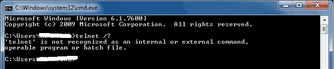

How To Enable Telnet On Window 7, Window 8 & Window Vista
How to fix it
Click Microsoft Windows Start menu and choose Control Panel.
Double-click the Programs and Features icon.
Along the left side, click the Turn Windows features on and off link
Log in as the "Administrator" if the User Account Control window opens.
Click to select the Telnet Client checkbox in the Windows Features window.
Click Ok.
The telnet installer will install the feature.
Important: Please allow a few minutes to complete the installation.
You may be required to restart your system.
EASY OPENING TELNET BM622M V21,V22 AND BM623M
JUST FOLLOW THE IMAGE
use google chrome

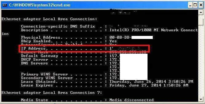

First thing to do is to know if what is your Wimax modem IP address. If you know already your IP skip to Step2. Here's how to check your current IP address on DV235t wimax modem?
Go to CMD > type "ipconfig /all" without quote and look for Local Area Connection > IP Address and that is your modem IP. Look at the photo below.
How To Check / View DV235t modem IP address
My LAN IP Address

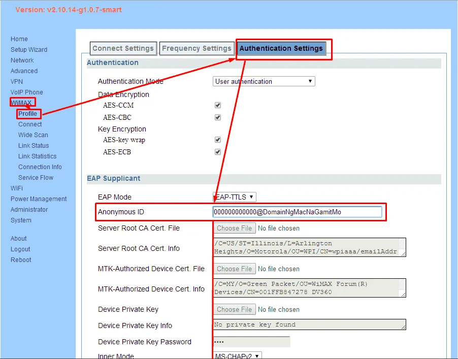

Step3:

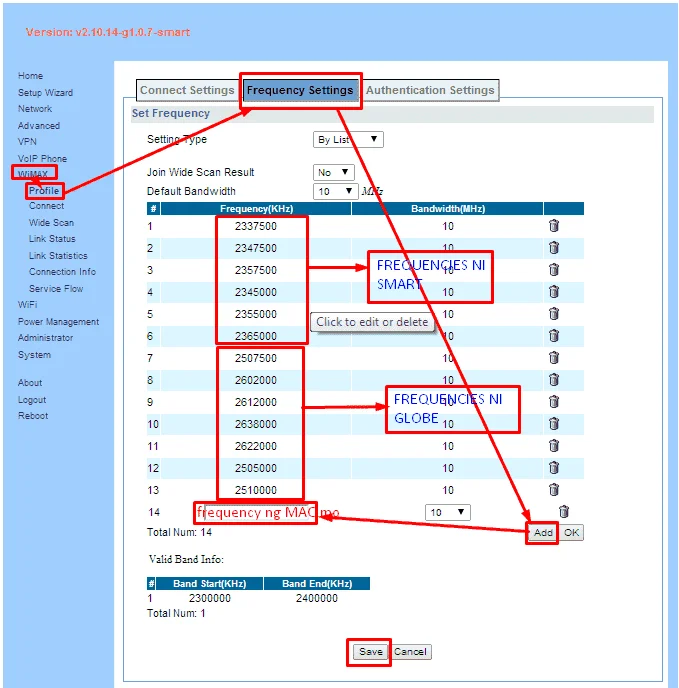

Now we need to change your frequency. How to change frequency on DV235t modem? You can simply visit my older post it easy as 123 How To Change Frequency DV235T | Turbo Change Frequency Script for GLOBE, SMART, WITRIBE Frequency
Step4:

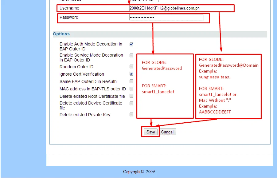

Change the authentication for Globe or Smart to be able to connect your MAC address. Go to Wimax > Profile > Authentication Settings you need to generate password on this step you can download one password generator posted in BM622, BM622i BM622m Admin Password Generator once you got one then make sure to follow this format.
FOR ANONYMOUS ID - GLOBE
ANONYMOUS ID: MacWithout":"DomAin
Example:
AABBCCDDEEFF@globelines.com.ph
FOR ANONYMOUS ID - SMART
Example:
AABBCCDDEEFF@smartbro.net
FOR USERNAME - GLOBE
USERNAME: GeneratedPassword@Domain
Example:
2008B6ByVOLzBZWF@globelines.com.ph
PASSWORD: GeneratedPassword
Example:
2008B6ByVOLzBZWF
FOR USERNAME - SMART
USERNAME: smart1_lancelot or MAC without ":"
Example:
AABBCCDDEEFF
PASSWORD: smart1_lancelot

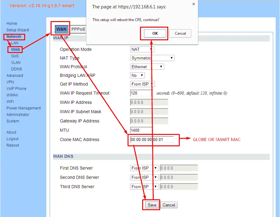

Go to Network > WAN then key in your live Mac Address for Globe or Smart. I posted live / working mac addresses here Free 2-3MB Live Mac Address for BM622m, BM622i, BM622, BM621, BM623m, My Bro DV235t Globe if you want solo mac address you can follow us on facebook page or you can snipe or hunt mac address also on your own.
How To Change Mac DV235t MyBro
DV235t Change Mac Address
Click Save and wait to reboot your modem and enjoy you are now reconnected.

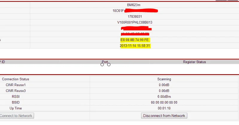

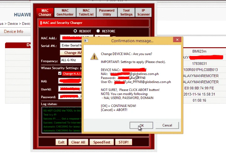

BM622M AND BM623M REMOTED EASY FIX
Recently someone got into my BM623m he change my mac address to GALAXTMANREMOTER.
Wonderful whoever this person who thanks he his now a häçker after just doing this. All i can say Conrgatulation NOB.
HERE'S THE FIX
1. Login as admin open telnet change Mac.
all done.
