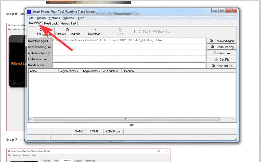

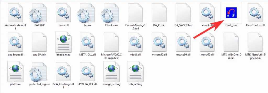

Step 4: Now go to the extracted folder in Step 1 and open up the SP Flash Tool sub-folder. You will find “Flash_tool.exe” file in it. Launch it.
Step 5: Once SP Flash tool is launched, click on “Download” tab.

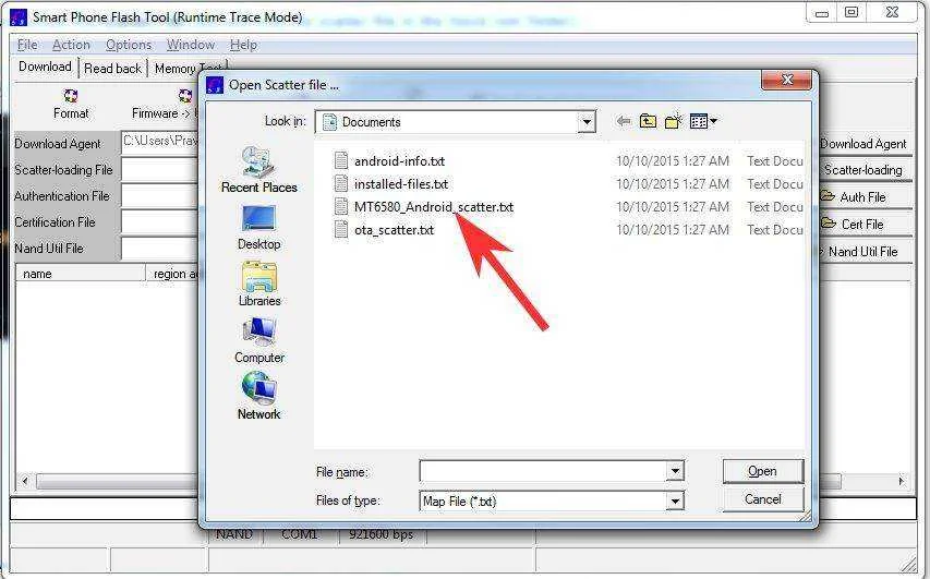

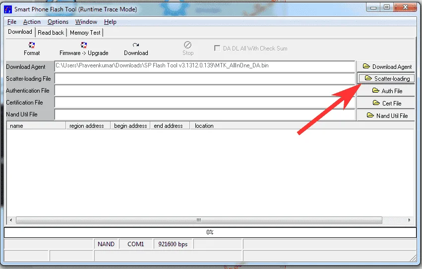

Step 6: Now, click on “scatter-loading” button in the download tab.
Step 7: Next, click on “Open Scatter File” and select the scatter file from Step 1. For reference see the image given below.

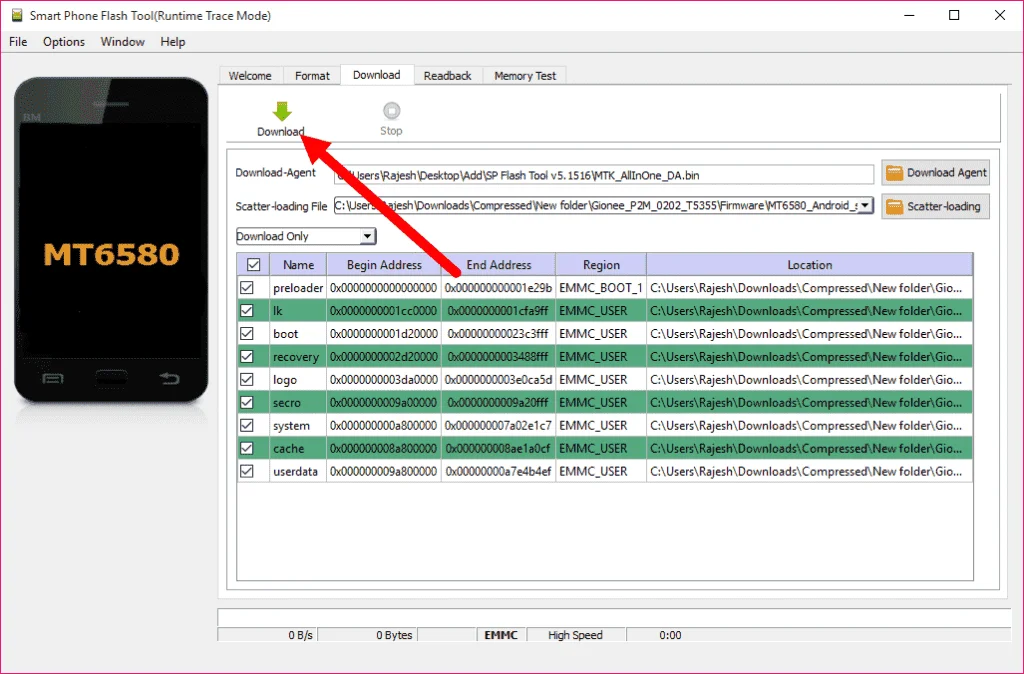

Step 8: Now click on the “Download” button to start the flashing process.
Step 9: Next, connect your Lenovo A536 Android device to your computer through original USB cable (without battery – if it is battery removable) and press volume up or volume downbutton.
Step 10: The flashing process will begin momentarily, and it will get completed in a minute or two. Once it is over, you will see the “Download OK” green ring in SP Flash Tool.
