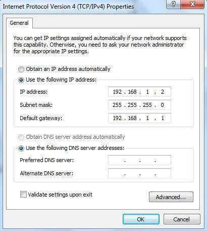

1. set static ip

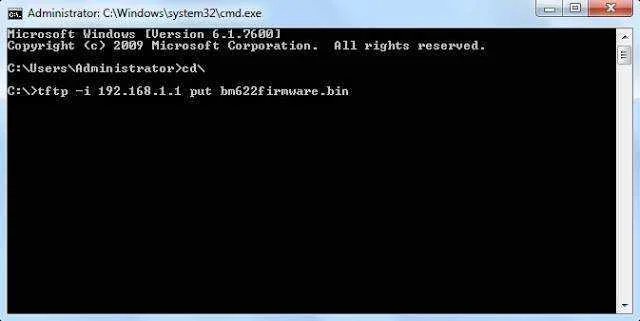

3. Click START and RUN, then type cmd to open windows CLI (command line interface) mode
4. Type cd\ to change directory i.g. C:\
Make sure your bm622firmware2010.bin is in local drive C:\
5. Type tftp –i 192.168.1.1 put bm622firmware2010.bin as you can see from the screenshot below, wait DO NOT press enter yet until to do so.
