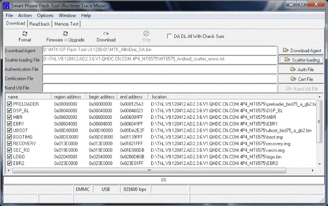

  • Next is the Software Upgrade Tool. Open the folder Lenovo A369i_Software Upgrate Tool and run Flash_tool.exe
  • Click File -> Open Scatter-loading File... -> browse to the folder Target_bin and click the file MT6572_Android_scatter.txt
  • Check the box DA DL All With Check..

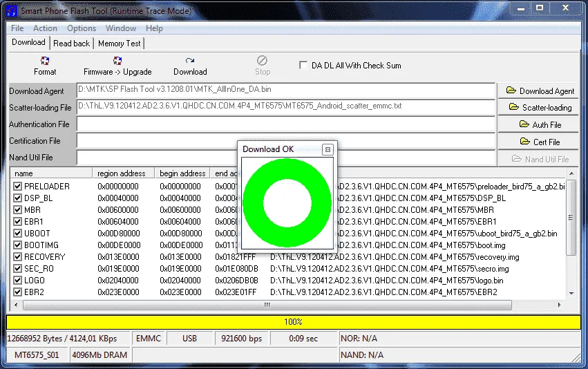

  • If you did it right it will start downloading files into phone. This will let us avoid future errors like error in partition in SDCARD. Wait for the GREEN CIRCLE to pop out.

  • Unplug USB cable, then plug it again, for 1.5 sec click Firmware -> Upgrade button.
  • Wait for it, it will take time. Even if it shows 0% it is still working its magic. You just need to wait for the GREEN CIRCLE to pop out.

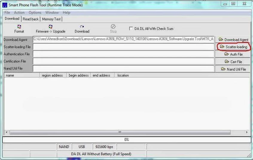

3.Start the flash_tool.exe from second folder and choose from the middle right Scatter-Loading and point it to the third folder and choose the scatter file
4.the files will be loaded
