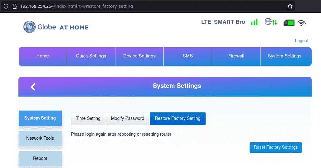

❓ Help how to reset the globe streamwatch xtreme router? (sei-120g)
can't find videos or articles about how to properly reset the globe streamwatch xtreme router. pressing the reset button for any number of seconds is not working kasi so i think may iba pang dapat gawin. di ko na kasi maalala username or password ko sa gui 192.168.254.254 so i'm planning to default it na lang sana. i'd appreciate if anyone can help.

  • Make sure to remember if you changed the IP address ng router. If so, that IP address will be the default GATEWAY address ng router. Kung hindi naman at nadisabled lang ang DHCP, mas madali. Defualt Gateway/IP address ng router is 192.168.254.254.
  • Connect to Streamwatch Xtreme via LAN or WIFI but configure the IP address to STATIC and 1 unit less than the Gateway/IP address ng router. Example: If router’s IP address: 192.168.254.254 use STATIC IP address 192.168.254.253
  • If using LAN on your PC/Laptop, don’t forget to disable and enable the network adapter to refresh the settings. This is usually automatic using WIFI.
  • Then, on browser you can now access the dashboard again by typing the Gateway /IP address ng router. Example: 192.168.254.254
  • Log in and do a factory reset para marefresh lahat. Hope this helps.

sa akin ay maling ip nilagay ko sa aking sei 120g sa dashboard niya. so di na ngayon mapunta sa dashboard. baka may solution ka na diyan ssob?
may solution po tayo jan gamit ang PC o laptop.
_connect via lan or wifi
_pumunta sa Control Panel\Network and Internet\Network Connections
_i-right click ang lan o wireless network kung saan ka naka connect
_click properties
_click ang mismong " internet protocol version4 (TCP/ipv4)" h'wag i uncheck
_click properties
_i type sa ip address 192.168.254.250 then enter
_i type sa default gateway 192.168.254.254
_i-check ang "validate setting upon exit"
_click advance settings then "OK"
_click "OK" again
punta kna sa 192.168.254.254
kung ayaw punta ka sa 192.168.254.250...
eto gumana saken! wew! salamat boss!!
