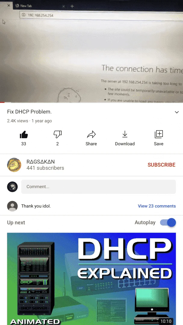

Baka po makatulong itong vid na 'to from yt para sa mga hindi ma-access ang 192.168.254.254 kasi na-disable nila dhcp.

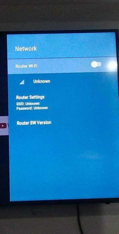

Hindi po mabago yung password or kahit mabuksan. hindi kaya.. unknown po yung nalabas sa network ,kapag inaactivate sya, nag didisable lang . at hindi ako makaconnect sa wifi .
UNKNOWN lahat ng nalabas sa info nya

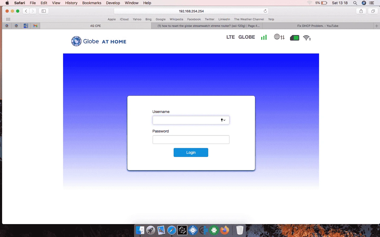

Hi, paanu po ang sa apple macbook pro? Kailanagn ko po hard reset ang Globe At Home Xtreme. nakalimutan ko na po and admin user at password. Hindi ko po maacess yan. please hep. Itried many times ang reset button pro nothings happen.
Globe Streamwatch Xtreme Obtaining IP/DHCP error/unable to access dashboard/gateway after bridging fix
  • Make sure to remember if you changed the IP address ng router. If so, that IP address will be the default GATEWAY address ng router. Kung hindi naman at nadisabled lang ang DHCP, mas madali. Defualt Gateway/IP address ng router is 192.168.254.254.
  • Connect to Streamwatch Xtreme via LAN or WIFI but configure the IP address to STATIC and 1 unit less than the Gateway/IP address ng router. Example: If router’s IP address: 192.168.254.254 use STATIC IP address 192.168.254.253
  • If using LAN on your PC/Laptop, don’t forget to disable and enable the network adapter to refresh the settings. This is usually automatic using WIFI.
  • Then, on browser you can now access the dashboard again by typing the Gateway /IP address ng router. Example: 192.168.254.254
  • Log in and do a factory reset para marefresh lahat. Hope this helps.
