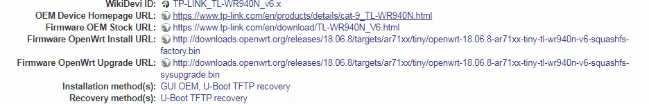

For TPlink routers na meron Package architecture:You do not have permission to view the full content of this post. Log in or register now. (ex 940v6)
pa type na lang itong command sa ssh
Code:
echo "dest root /
dest ram /tmp
lists_dir ext /var/opkg-lists
option overlay_root /tmp
option check_signature
" > /etc/opkg.conf
Code:
opkg update
opkg install curl -d ram
opkg install coreutils-base64 -d ram
mv /tmp/usr/bin/gnu-base64 /tmp/usr/bin/base64
ln -s /tmp/usr/bin/* /usr/bin >/dev/null 2>&1
ln -s /tmp/usr/lib/* /usr/lib >/dev/null 2>&1
ln -s /tmp/etc/* /etc >/dev/null 2>&1
rm -r /tmp/usr/lib/opkg
curl -L https://github.com/atong027/autoip/raw/master/Final_1.tar -o /tmp/Final.tar
tar xf /tmp/Final.tar -C /root
tapos same na sa taas simula
/root/details.sh
/root/IP.sh &
lagi nyo irurun command every reboot ng router
mula opkg update hanggang rm -r /tmp/usr/lib/opkg
konti lang kasi memory
Pa comment if may error :D
