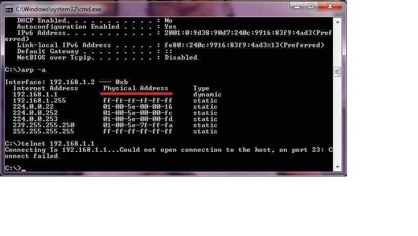

Problem :
  • cant access GUI via 192.168.1.1
  • cant access TELNET via "telnet 192.168.1.1"
= ITS A FIRWARE DESTROYED issue. too bad...
Steps i've done :
  • resetting the MODEM BM622 (pressing reset button)
  • uncheck / recheck the "telnet" in windows setting (reboot)
  • "apr -a" shows the IP in default 192.168.1.1 still cant access GUI/TELNET
  • connect using router (reset) also done
  • connect directly to the model also done.
  • i formatted my PC to see if it can resolve the issue, but still no avail.
Note: this issue occured last saturday, but my modem can still connect to the internet i just cant access GUI from browser (firefox,IE,Chrome) page cannot be displayed, error on page. even CLI cant do anything.

as of now, on-going reflash ako ng FW IC nya, kasi ang WAN IC ko ok naman at may internet, so since na pasukan siguro ng script, might as well erase the FW and flash a new program. update ko ito kapa nag ok :)

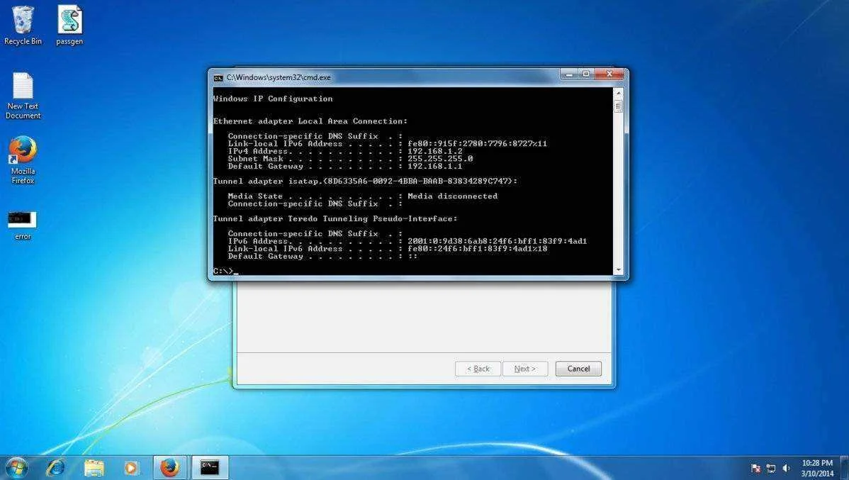

ito po ang way nlng ahm punta ka sa control panel>network and internet> network &sharing>Change adapter settings>Right click mo yung adapter ng wimax mo then click properties> hanapin mo yung Internet Protocol Version 4 (TCP.IPv4) click the properties> check mo yung Use the following IP address>
ito ang ilagay mo
Ip address: 192.168.1.2
Subnet mask: 255.255.255.0
Default Gateway: 192.168.1.1
then OK then try mo mag log in sa gui try and try lng or reload.
@ GravityZer0 - same same sir no access kahit static ko yan ip nya... :(
edit: SOLVED na!!!
reprogram the FW IC using copy machine. tried it too many times, i think 12x .. remove IC, program, mount, paulit ulit hahaha :) ayus!!!
ok na telnet login ko
ok na GUI login ko..
