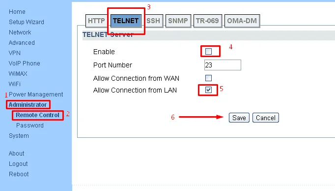

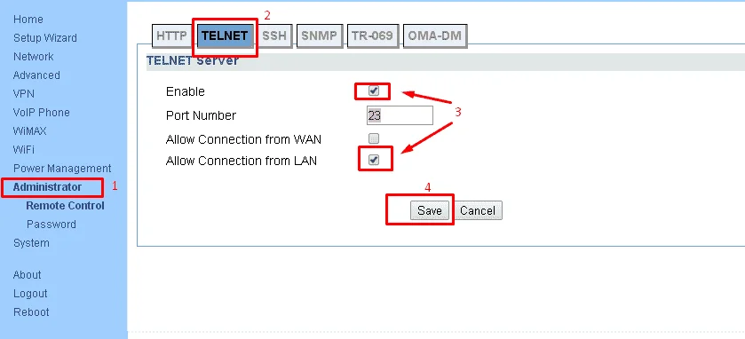

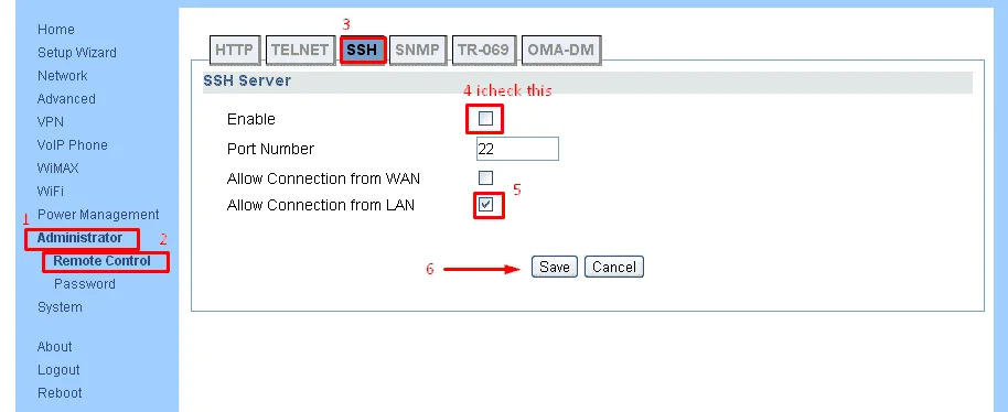

STEP1: SIGURUHIN PO NA OPEN ANG TELNET NYO "TANONG PANO": PUNTA SA ADMIN GUI
YUNG "LAN" LANG PO ANG LAGYAN NG CHECK PARA DI PO KAYO MAREMOTE
NG MGA FLLING häçkER.:mad: THEN SAVE NYO NA PO

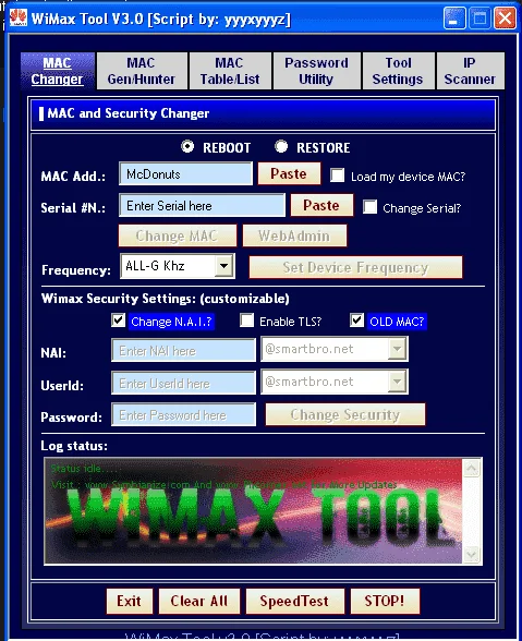

STEP2: OPEN NYO YUNG "SMARTBRO DV235T TOOL"
STEP3: PUNTA SA "TOOL SETTINGS"
STEP4: PAG OK NA READY TO CHANGE MAC NA YAN BALIK KA SA "MAC CHANGER" PASTE MO ANG MAC DUN SA "MAC ADD" THEN CLICK MO YUNG "CHANGE MAC"
WAIT MO HANGGANG MATAPOS SYA MABASAHIN MO YUNG MGA LALABAS SA "LOG STATUS"
PARA MALAMAN MO KUNG TAPOS NA MG CHANGE MAC

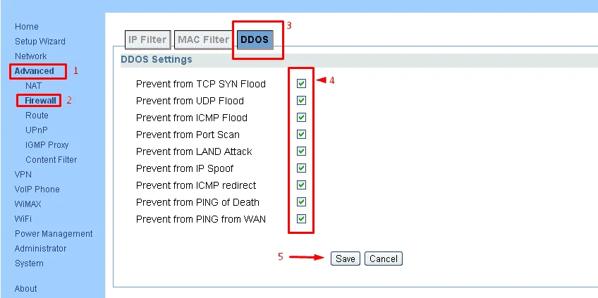

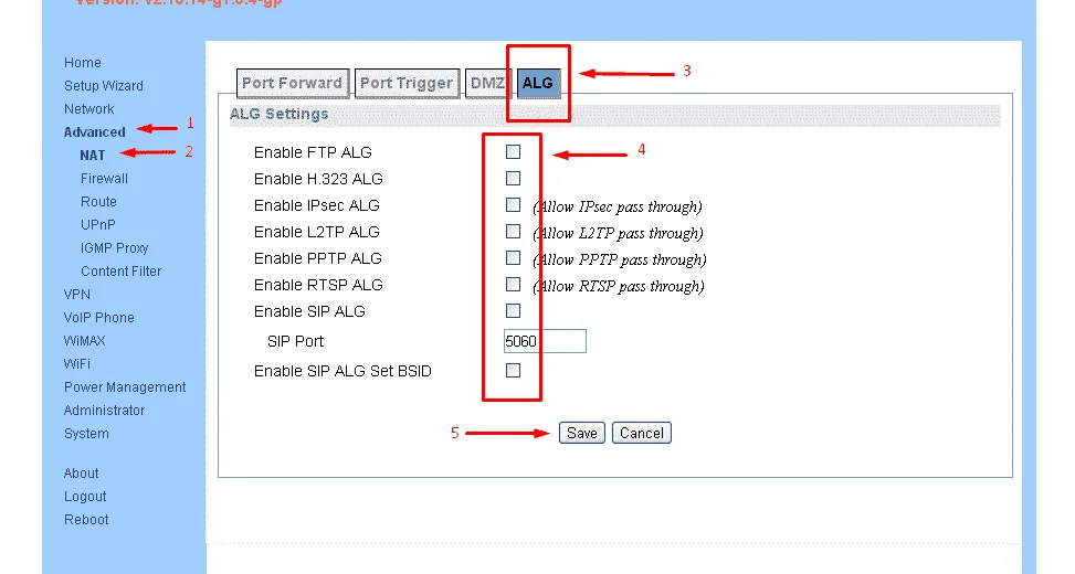

Enable mo lahat ng item sa DDOS parang ganito :LOL:

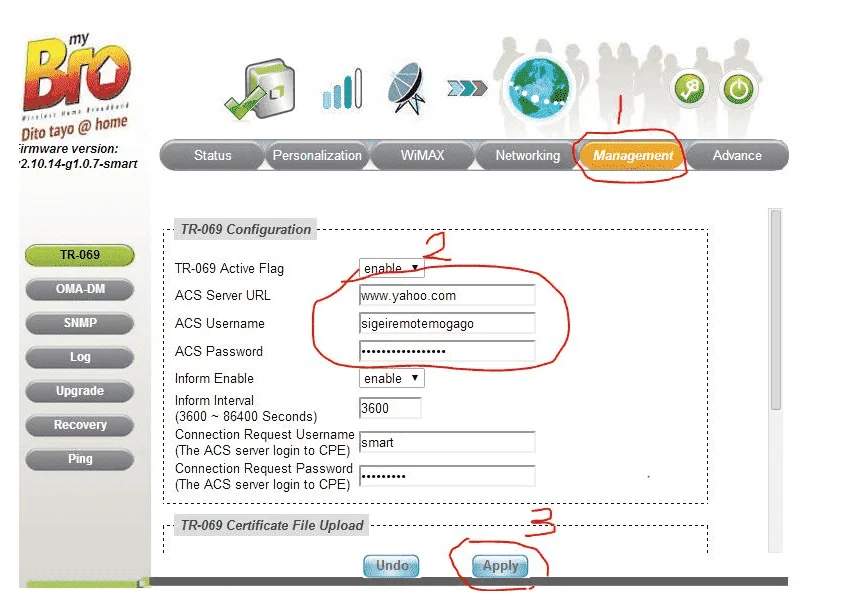

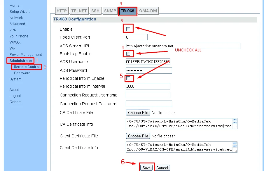

Tapos para hindi ka naman maremote ni smart eto gawin mo. Uncheck yung sa TR-069.:love:

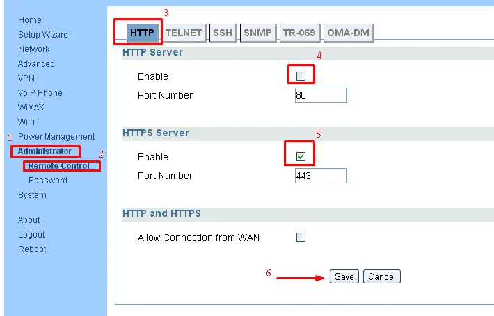

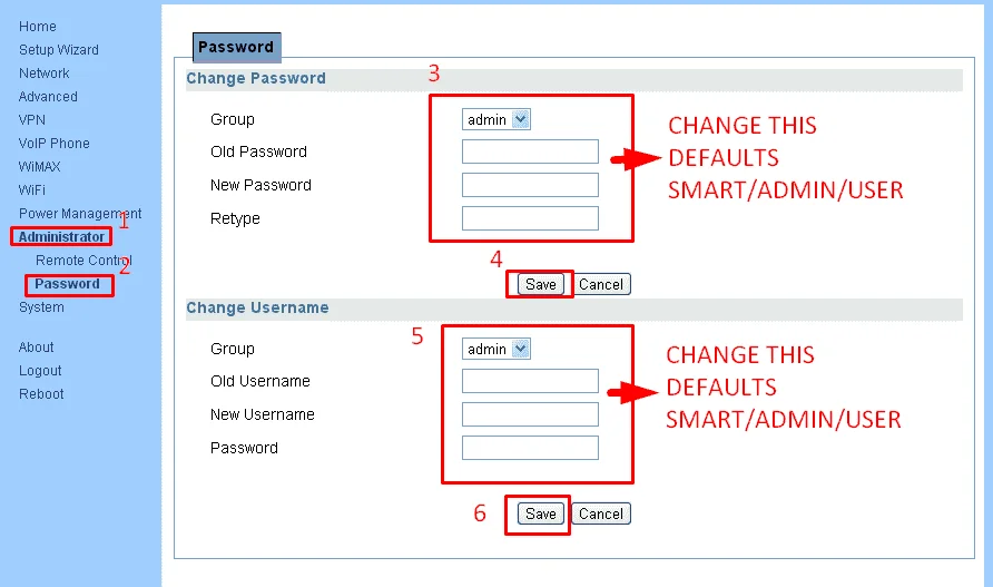

change user and password nyo din admin/admin user/user smart/smart nyo. Click nyo lang ito.:ROFLMAO: CHANGE DEFAULT PASS AND USER"​
HETO BAGO PARA DI TALAGA MAPASOK BAGUHIN NYO PO DATI NA NAKALAGAY JAN KAHIT ANO PWEDE!🐱
Protektado na ni Asiong DV-235T mo (y)

Pagnaka stock "MYBRO" Fw kayo dito naman kayo pumunta para sa SSH nyo.You do not have permission to view the full content of this post. Log in or register now.

Para sa complete protection login kayo as admin sa GUI nyo and disable yung dapat idisable sa firewall.

Para di mag update ang Firmware natin to V8 do this~!:ROFLMAO:

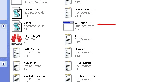

run the scipt named "admin wimax"

NOTE : Sa mga naka windows 7 and above make sure na naka enable yung TELNET nyo before running any script.
Pano mag enable ng telnet? read this : You do not have permission to view the full content of this post. Log in or register now.

[TUT]HOW TO CHANGE MAC FOR DV235T​
FIRST OF ALL DOWNLOAD NYO MONA YUNG TOOL DUN SA NAKA ATTACH SA BABA
CREDIT KAY YYYXYYZ ANG TOOL..DITO KO NA LALAGAY PARA DUN SA NAGTATANONG KUNG PANO MAG CHANGE MAC SA DV235T
