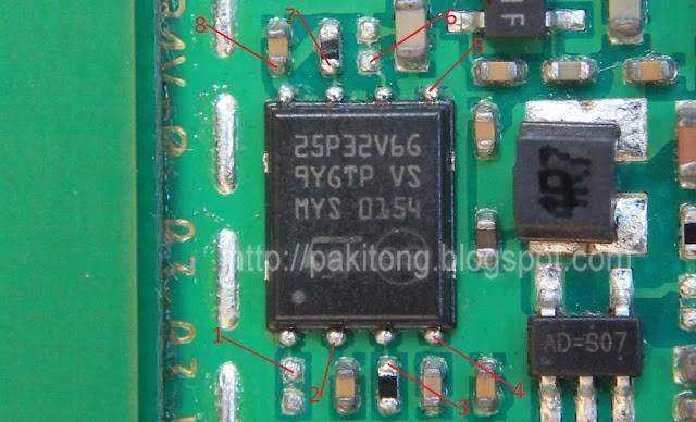

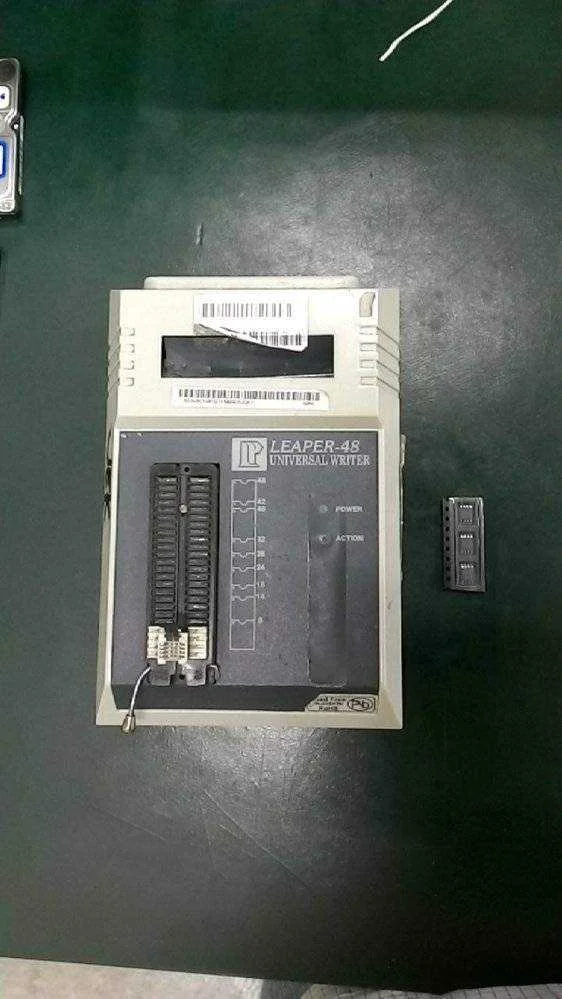

today i searched to many forums, and links, that leads me to programming WAN EEPROM IC, i downloaded bin files that i could use to program the EEPROM, and hey... since im working on a repair site for DT/SV/NB VoIP/LCD i know how to program MAC/WAN bios and others (yabang..) i gathered thing and infos i needed, like what kind of an EEPROM top mark of the IC, programmer device that i need to use. luckily our warehouse got components i need to program the IC
ST micro M25P32
top mark (25P32V6G)
PN: 77P7524AA
bin file for BM622
Leaper48 Universal IC writer
nakakatuwa lang.. pag pumayag yun friend ko..susubuka ko ito :)
inputs are welcome :)

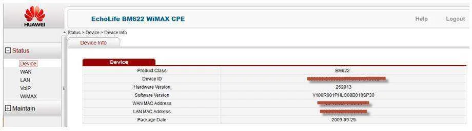

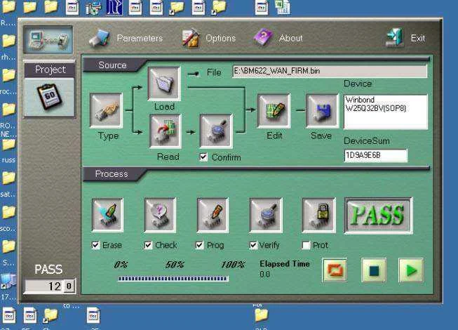

Update: BLANK WAN solved!!

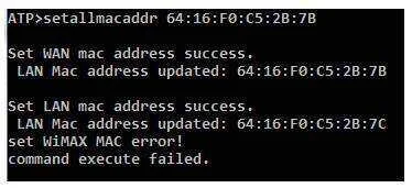

after a few IC i tried using dump i got from the internet, i finally can change mac and write it for WAN and LAN.
picture below came from sir Jo. it is thesame original mounted IC from my blank wan TABO BM622, reflashing the IC solves it. i found out that my sub part IC cannot perform change mac, and it only gives me the error of "set WiMAX MAC error!"
see some of my SS below.

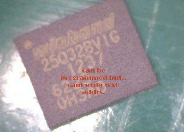

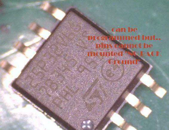

just an addition, eto yung gma IC na di pwede magamit na natry ko :)

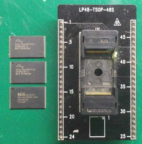

@ Clarkz - bro thank you hehehe... tumagal yung process ko kasi i have 1 x.bin file for the firmware, na ka pag proram ako ng 2 kinds of IC spansion and MX IC but after mounting the IC my maibboard resulted to no work.
i programmed 2 different IC's SPANSION and MX IC both TSOP48 i even tried TSOP56 all those IC did work, i thought at first that it was the IC who is not compatible with the mobo. so what i did next is to copy/dump the FW IC i have came from my mobo, tho i know there is something wrong with my FW. i compare the checksum from x.bin file i use vs. y.bin my dump. i noticed that there is a difference, what i did next is to search the google for the FW 2009 package of BM622, after download and tried it on my original IC, it works ok now. telnet and GUI reset to original login and passwords.
update:7:00am 3/13
today i will try my working bin file, to different IC that i used yesterday, im thinkin that those IC can work also with a good working bin file. SPANSION and MX IC.
picture of IC's and programmer socket i used.

@ Cleriss623 - bro, yung mga gamit ko dito sa company those are made to order sockets for IC, different IC corresponds to difference programmer. ano ba issue ng tabo mo? BLANK WAN or na FWD?
