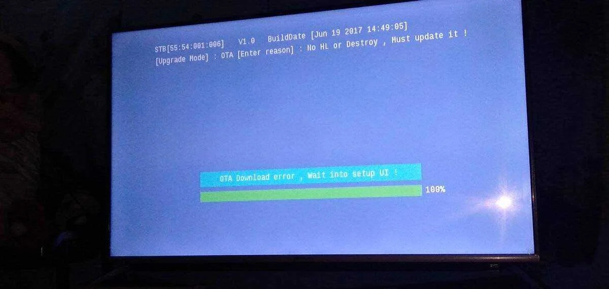

Ano po dapat gawin? Yung TV plus ko kc nag auto update? Then every 100% na nung update. Update error naman sya. Ayaw din mag exit nung update. Di na ako maka panood kasi paulit ulit Lang sya. Baka may paraan po KAYONG Alam like hard reset PO neto? Please help po :'(
Hi,
Try mo pong sundin ang mga sumusunod na STEPS sa ibaba, Then thank me later:
STEP 1: Turn-on TV Plus
STEP 2 Wait for the "Upgrade Menu Screen" to Appear
STEP 3: Select "Frequency" and encode 647143
STEP 4: Go to "Bandwith" then press "OK" to start OTA download
*NOTE:
Green progress bar and value should increase. IF NOT, check the antenna/Signal reception, advise to reposition if having poor signal reception.
STEP 5: During OTA Download, DO NOT TURN OFF YOUR TV PLUS, it will automatically reboot after successfull OTA software upgrade.
Note: ang 647143 ay Frequency ng para sa mga nasa METRO MANILA lang. Mas maiging alamin muna ang frequency ng inyong lugar/area para makasigurado.
