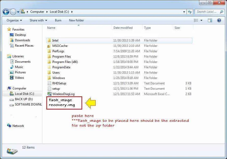

1. copy You do not have permission to view the full content of this post. Log in or register now. to drive c:
2. copy
You do not have permission to view the full content of this post. Log in or register now.You do not have permission to view the full content of this post. Log in or register now.to drive c:

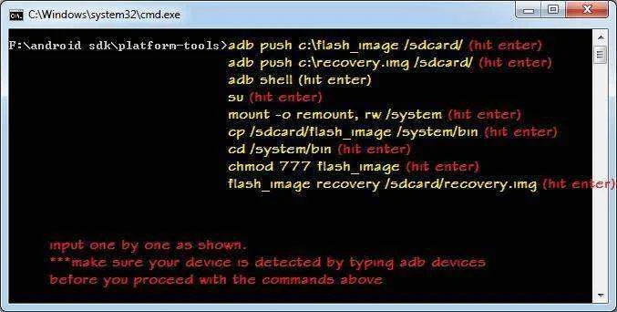

4. open adb sdk platforms and open cmd
5. type in the ff:
adb push c:\flash_image /sdcard/ (hit enter)
adb push c:\recovery.img /sdcard/ (hit enter)
adb shell (hit enter)
su (hit enter)
mount -o remount, rw /system (hit enter)
cp /sdcard/flash_image /system/bin (hit enter)
cd /system/bin (hit enter)
chmod 777 flash_image (hit enter)
flash_image recovery /sdcard/recovery.img (hit enter)
It has now been flashed successfully !!!

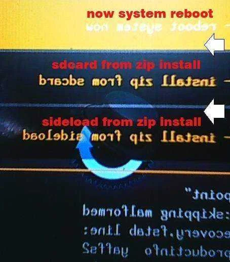

6. now enter into recovery mode
7. Power+Volume down, release power after 3 seconds, then release volume down after
8. Now navigate to wipe data/factory reset via the volume buttons and select via the power button
9. Wait as it restore your phone to the default settings and you have unlock your phone

option 2
  • download mobileuncletools and install to phoneYou do not have permission to view the full content of this post. Log in or register now.
  • copy paste the recovery.img into your sd card (no need to create folder, simply paste)

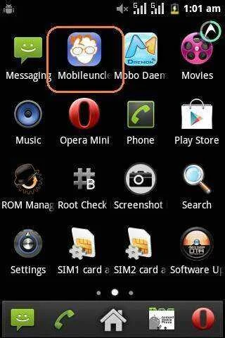

  • open mobileuncletools

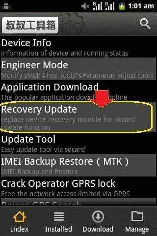

  • click on recovery update
  • select recovery.img

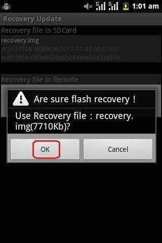

  • flash recovery.img click ok

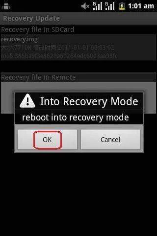

  • reboot to recovery-click ok
  • wait as it reboots and your done- you should be in cwm recovery mode already
