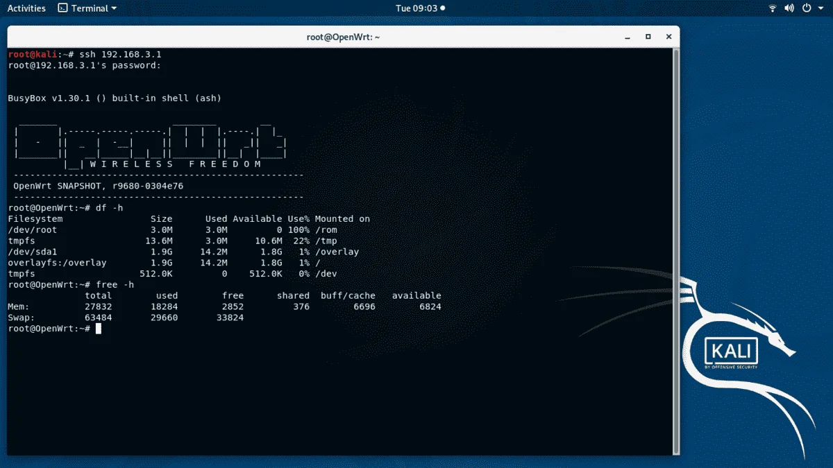

SOFTETHER UPDATE:
test device:
tplink MR3420 V2 (4/32mb) WITH USB PORT FOR EXTROOT
EXROOT FLASH: 1.8 Gb
RAM Swap: 64Mb
