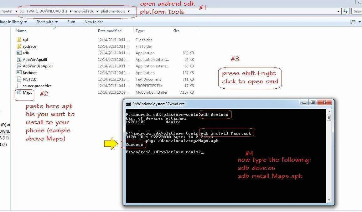

option 1:
  • pag nasa recovery mode po kayo choose wipe data/factory reset
option 2: "usb debugging enabled a must!" before error occured
  • pero pag ayaw nyo marestore to factory para di mabura mga nainstall nyo na apps kung naka enable "usb debugging" bago madelete ung systemui.apk gamit po kayo android sdk tool.
  • kailangan meron kayo ung systemui.apk tapos save nyo sa android sdk platform folder kung saan nakainstall ung android sdk
  • open lang ung folder kung saan nasave ung android sdk platform open po kayo cmd dun tas type the ff:
    adb install systemui.apk
  • check nyo lang dito regarding sa mga possible tools para mainstall sa phone You do not have permission to view the full content of this post. Log in or register now. ung systemui.apk
  • or if wala kayo nung apk try nyo nalang itype: adb reboot boot loader
sample attached image kung pano ung process

option 1:

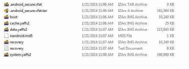

3. pero kapag may kopya po kayo ng ROM na ini install nyo is naka folder like
  • 2014-01-21-09.00.18
  • copy nyo lang ung folder na 2014-01-21-09.00.18 sa sd card (remove muna sa phone ung sdcard at transfer nyo yang folder then ibalik ulit sa phone, kung may clockworkmod na folder sa sd card dun nyo ilagay create din kayo ng folder named backup kung wala pa /sdcard/clockworkmod/backup/2014-01-21-09.00.18)
  • kung walang clockworkmod folder just paste nalang ung folder sa /sdcard /2014-01-21-09.00.18
  • then try nyo na ulit mag boot via recovery then back up & restore hanapin nyo nalang ung folder

di po madedetect kapag:
using adb
  • spreadtrum drivers not installed
  • usb debugging not enabled
  • 0x1782 not incorporated in adb_usb.ini from android sdk tools
using moborobo (auto installs spreadtrum drivers when detected)
requirement: usb debugging enabled
using adb
