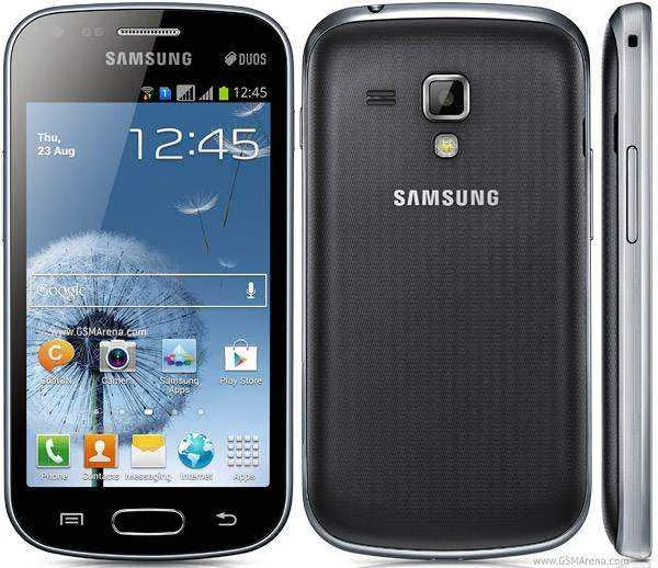

The Samsung Galaxy Duos S7562 is a dual-SIM version of the original Samsung Galaxy S, that made waves way back in 2010. The device is similar in most respects to the original version right down to its 4-inch display, 5MP camera, and the 1GHz processor. This guide below will show you how to root the newer one and enable you to install any root-requiring apps that you have always wanted. Read on then to root the Samsung Galaxy S Duos S7562.
