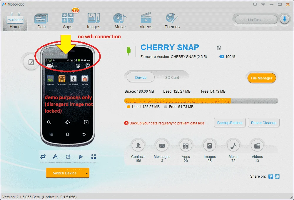

How to enable your wifi so you can log in to your google account for Android phones who have too many patterns attempt errors.

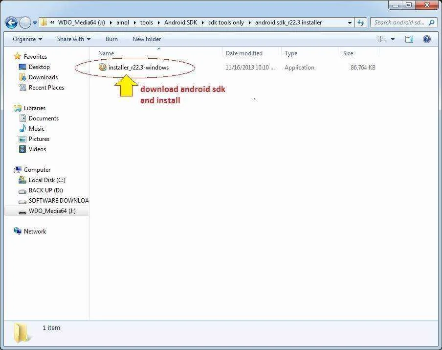

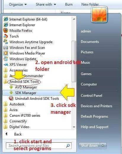

d0wnload application to pc and install

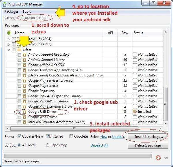

run application and open sdk manager

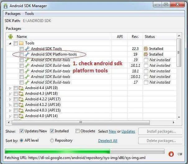

tick box for android sdk platform-tools, scroll to extras folder open and check google usb drivers

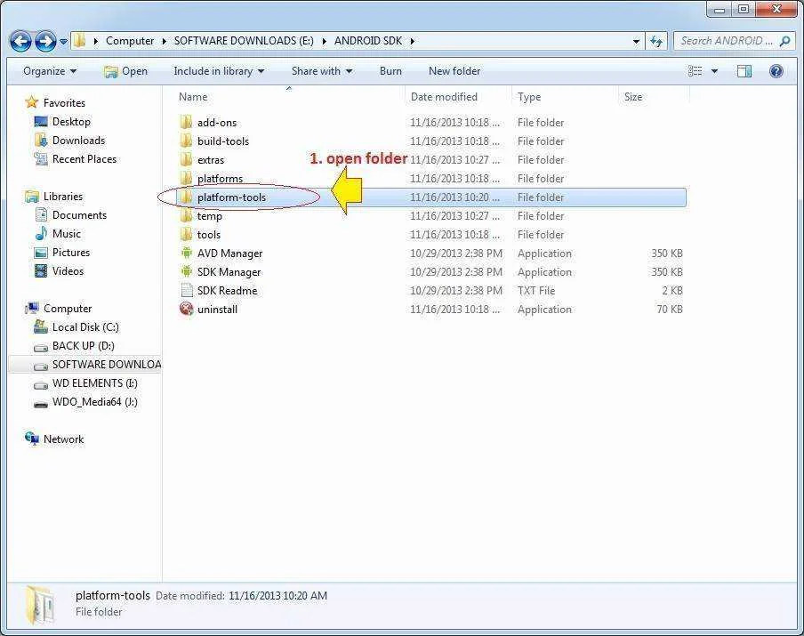

open the folder where you have installed android sdk (For the purpose of this tutorial mine is drive E:\ANDROID SDK but for the default its C:\Program Files (X86)Android\android-sdk.)

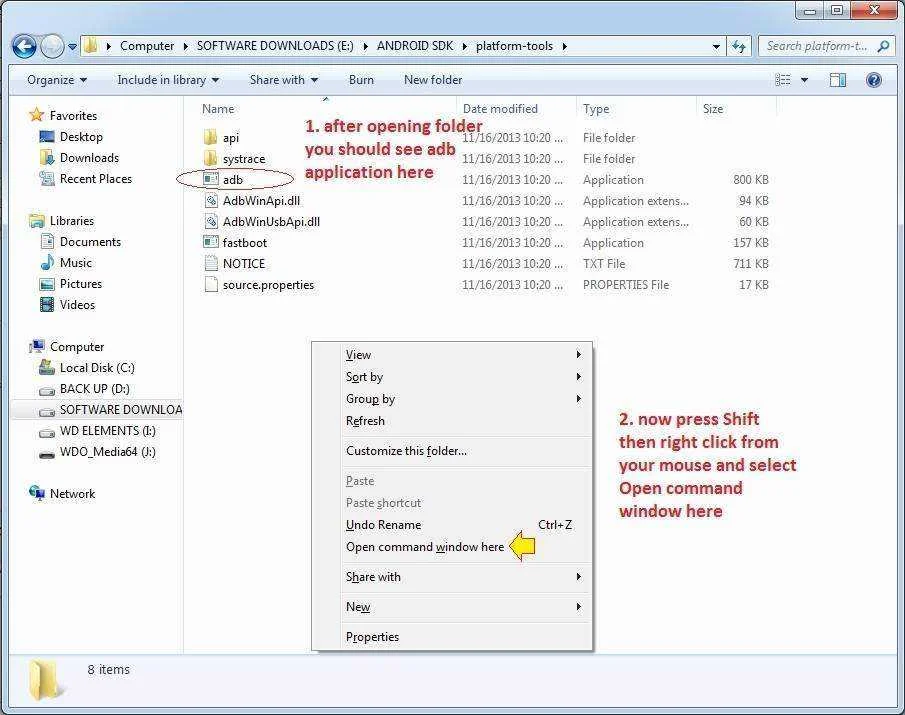

open a command window (hold or press shift then right click mouse)
connect now your android phone to your pc or laptop(this works only when you have checked previously the USB debugging of your phone before you got too many pattern attempt and got locked) and open moborobo

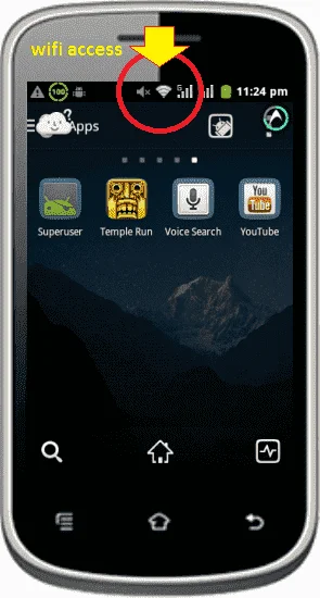

svc wifi enable (hit enter)
now wait from your device and see until wifi is enabled.
NOW START TO LOG IN TO YOUR GOOGLE ACCOUNT TO UNLOCK YOUR PHONE! GOOD LUCK! :)
