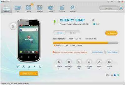

1. download both and install to your pc
2. open moborobo first

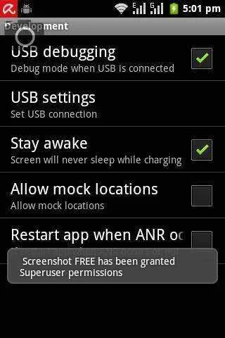

3. connect phone cm snap via usb cable to your pc (
check usb debugging mode-go to settings/application/development-check box on usb debugging), you may also check stay awake if you wish to.
4. wait until it recognize your cherry snap

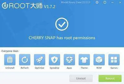

5. open v-root
6. click root button (sample above is already rooted-click root if device is not yet rooted)
7. wait until a message that your cm snap has been rooted (do not unplug phone)
8. your cm snap automatically reboots (wait until it's done)

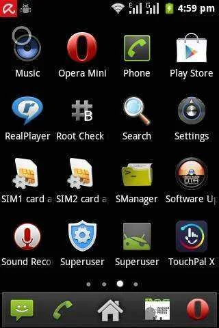

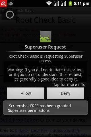

9. you can now see a shield icon color blue (this is the chinese superuser on your phone)
option if you don't like the chinese superuser you may download another superuser

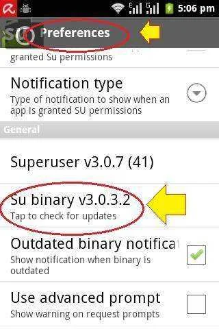

10. download superuser and update su binary FROM preferences
instead of the chinese superuser to be used it will be your own superuser like this:
YOU JUST SUCCESSFULLY ROOTED YOUR CHERRY MOBILE SNAP! CONGRATS!

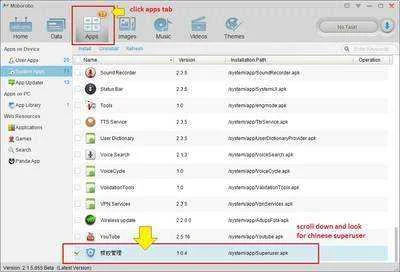

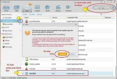

YOU MAY OPT TO delete the chinese superuser via MOBOROBO but DO IT AT YOUR OWN RISK IF SOME APPS WILL not work.
1. after updating your superuser open now moborobo. click the apps tab and scroll to your chinese superuser.

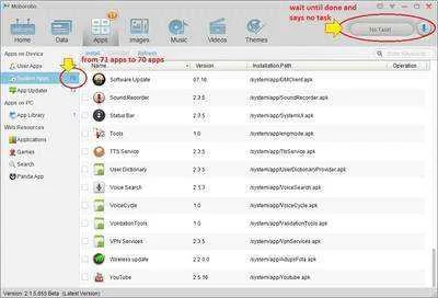

2. check and uninstall, wait until its done
3. you now have uninstalled chinese superuser

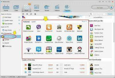

4. you may now also download apps from moborobo by clicking the application

patry muna sir download ng root checker app sa playstore, since may nakapag sabi na pre rooted na po ang cherry mobile hyper, at pag ung result ng root checker is "congrats!you have root access" download nalang po kayo ng superuser para mafull access nyo ang "root system"
