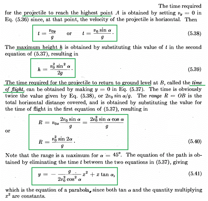

🎓 Academic Civil Engineering Board Exam Problems with Calculator Techniques (Casio fx-570es or fx-570es plus)
Bro meron din bang projectile motion cal tech? Yung prof ko kasi ang bilos mag compute sa calcu nakakaasar hahahahaha!!!
Just memorize this formula bro, these are the shortcuts formula.
