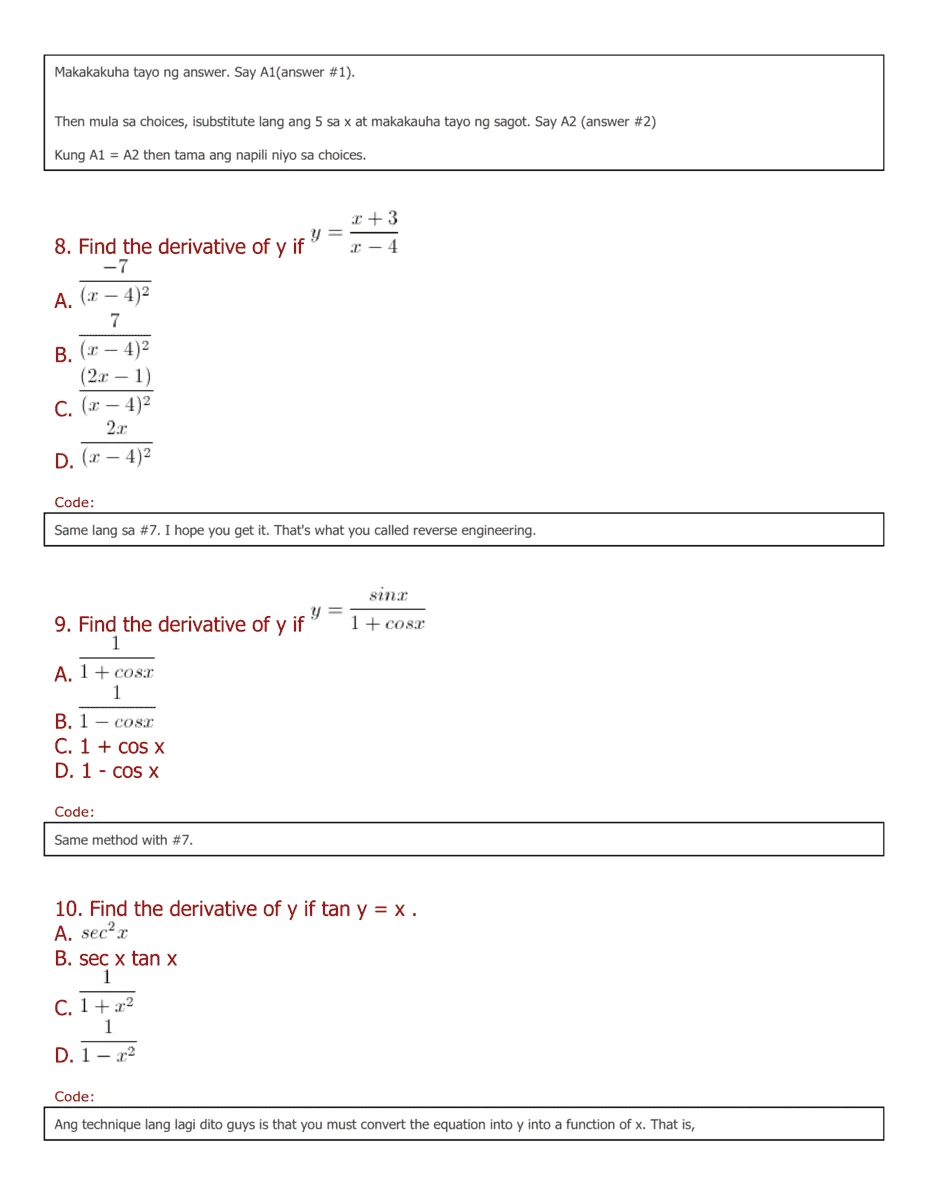

RHC CALCTECH: Problem No.4 (Mathematics) In the given problem, you can solve it in a fastest way using fx-570 calculator intended for Civil Engineering Board Exam.
  1. Find the no.of diagonal can be made in the given figure.
  2. Each of the interior angle of the given figure.
  3. Sum of the interior angle.
  4. Area of the given figure with side length.
  5. Area of the given figure inscribed in a circle with a given radius.

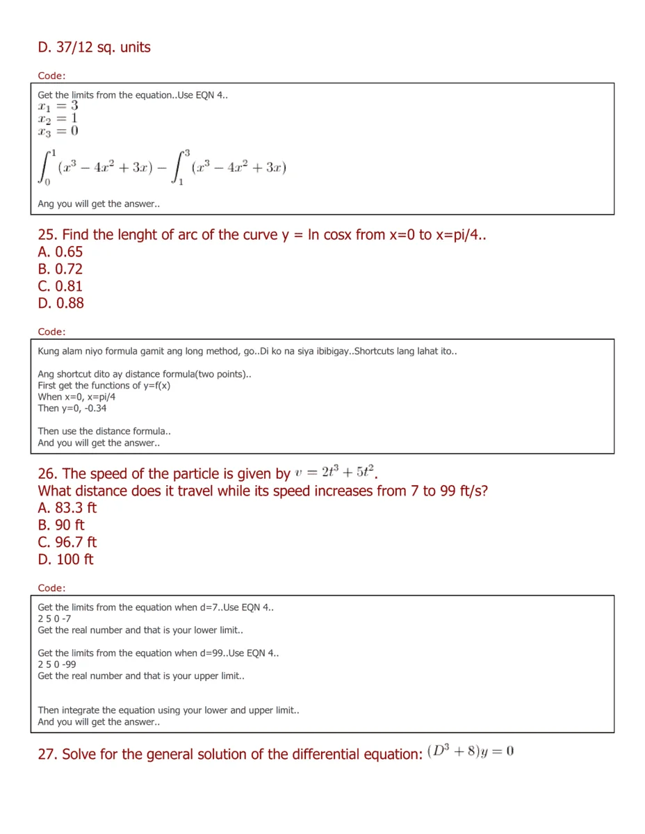

Mathematics Problems With CalcTech Solution
-credit to the owner

Continuation...
please change "z" to "c".
